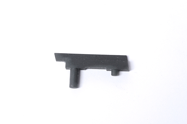

Compare your Colt ejector to the Wilson Super/9mm below.
Cut back the OEM Colt ejector- easier and quicker than waiting on Colt to do something.

Okay, the first time I blamed it on the "taller" Wilson ETM mags that actually touch the long dangly ejector on a Colt 9mm. It was a Colt Competition, which is exactly what I did with it the short time I had it, which included slamming mags in on the clock. Colt replaced the ejector under warranty with a slightly relieved ejector for 38 Super.
I sold that gun. I bought a Colt Combat Unit in 9mm yesterday that already has about 500 rounds through it. Ejector was straight as an arrow when I bought it yesterday.
Took it to the range and wasn't even doing my timed reload/mag changes (with gusto) like I usually do in my drills because it was so muddy I didn't want to drop the mags. Gun ran beautifully the first box of ammo.
I was running Dawson mags (Metalforms) that run great in my Fusion and a Dan Wesson I recently sold. These mags are a wee bit shorter than Wilson ETMs and don't contact the Colt ejector. After about 100 rounds the Colt started ejecting like it was popping popcorn all over the place. I unloaded and peeked at the ejector. Slightly bent.
I'm running quality brass case factory FMJ, 124 grain ammo.
WTH??
Any help appreciated.
I'll be calling Colt next week.
I have the same pistol (Colt Combat Unit 9mm) and I had the same problem. I sent it back to the mothership, and many moons passed before I saw that gun again.... however, when it did return to me, it had a MUCH shorter ejector on it, which I have had no more issues with.

I have had a lot of problems with 9mm 1911s braking the ejector. The problem has always been with 10 round plastic bottom magazines. The problem happens when the plastic base pad bends. When I complained to the first manufacturer of magazines that this had happened with he told me I was nuts, I sent him a picture showing the plastic base pad bent. He promptly sent me new extra thick base base pads. These magazines broke the ejectors in two Springfields and one Kimber 9mm. I bought a DW 9mm 1911. The ejector is a different shape than the other two guns and stopped the magazine on a tapered area locking it there. Anyway I got rid of those and purchased a different brand of 10 round 9mm 1911 magazines. Now I shoot most every week, Steel, USPSA, IDPA. In the last match I shot, in the last stage I had the same thing happen. This time when I called the manufacture, he told it can happen and how they fix it and sent me some new parts, but, I had to pay for new springs. Started assembling today when I received them. Expect them to solve the problem. Don't know if I should share the manufactures names on the form, but would not mind going into that with you if every thin works out.
