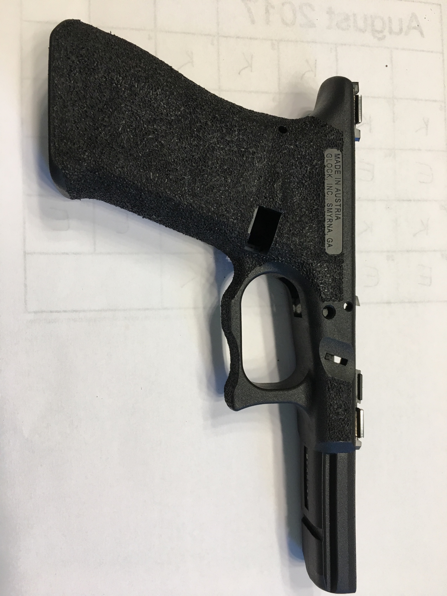

Well, thanks to a new frame I decided to try my hand at frame modification and stippling. I'm pretty happy with it for my first go at it.

Damn, that was quick! Looks good

The stippling on the undercut may run your fingers pretty badly. Looks good though.

It's stippled but then sanded down so at not really sharp, just textured to clean it up because the sanded areas color didn't match well.

Where I use the Dremel to shape, I will use several progressive grits of wet sanding paper to smooth it out. Then, I use Acraglas dye to color match. I have been told you can use Ritt Dye, but I haven't tried it.

When I did mine several years ago, I just polished it out with the dremel and some compound. Then used the acraglas dye. Worked good enough, cut down on time.
