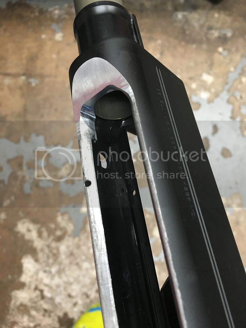

Port work being done by a new (to our area) local gunsmith. Guy has been to couple of gunsmith schools (for various types of guns) and worked elsewhere before moving back. His dad owns a building in town and had a bunch of equipment. I went visited his shop and saw some of his work. I showed him pics of what I wanted done. Wanted to stay local and support them. All the local shooters that have used them gave them high marks. He also supports the local range and shooting groups.

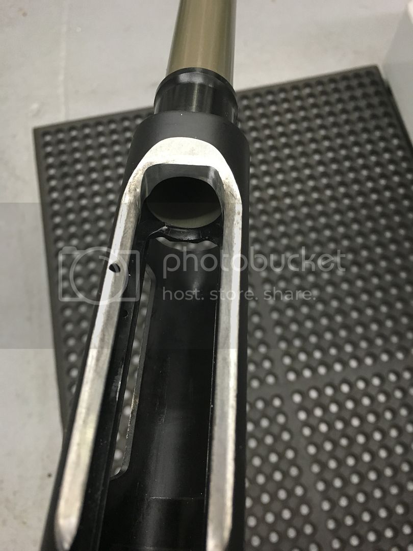

My Franchi Affinity is back!
Port opening work and milling for enlarged slide release by Andrew Schmitz (Schmitz Custom Arms)--see link below. He opened the port to my specified request. I'll be shooting three local 2-gun matches (lots of steel and distance targets) and three out-of-town 3-gun matches.
Next to Stoeger M3K
Perseus wanted his pic uploaded. :)
Web site of Schmitzcustomarms
http://www.schmitzcustomarms.com/

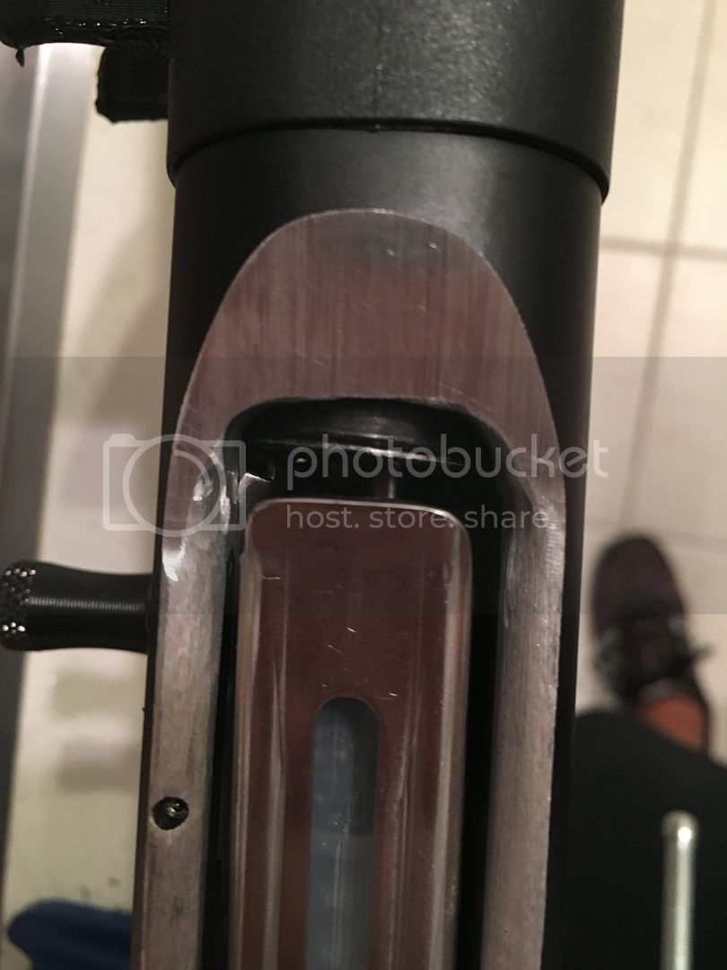

Here is a picture of my Franchi Affinity's loading port. Main cuts were done with a mill, then some shaping and rounding were done with a dremel. I now have over 1000 rounds through it with only user created hiccups. While tinkering with the magazine catch, I bent it closed a little too much and in the middle of a match had it start to dump rounds onto the carrier and impede my ability to load. As soon as I cleaned it and bent it back slightly, haven't had any issues. I run either a 12 round total or a 9 round total mag extension depending on what the match and class rules allow. I've installed all of the Taran upgrades available and used 3M auto double sided tape for the match saver. The t screws were going to be awfully close to the carrier bar...which brings up my question of the hour...for any of you that have had both the Stoeger and the Franchi, is the carrier bar the same between them? What about the bolt carriers? Thanks!
I wasn't able to compare them side by side, but the design does seem awfully similar - but I couldn't say that the parts are identical. What are you thinking of doing, trying to gain clearance for the match saver mounting points?
