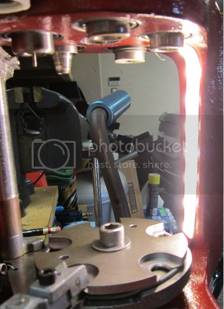

Just out of peripheral view
One trip to the hardware store, a little tap and die and wah-lah. One powder check mirror.

Some great ideas here. I am going to try the side mirror and a pen light. My press isn't able to be set up at the correct height, so looking into the case has been a pain.
Thanks for the info.
