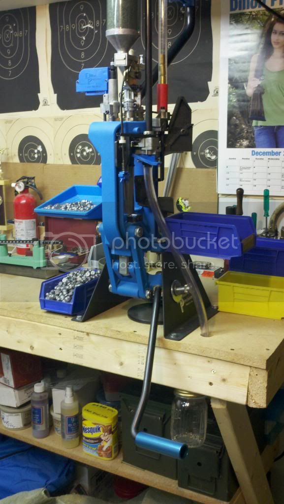

I got the Inline Fabrication LED, love it.....can see everything now.

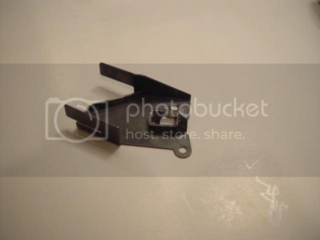

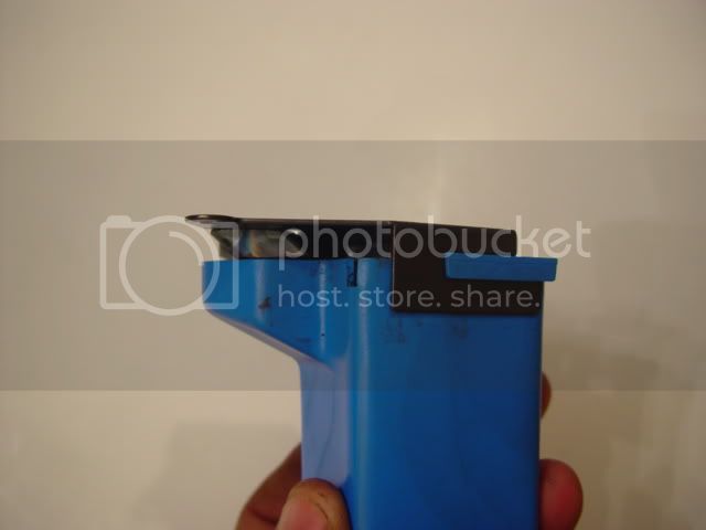

unique tech makes a primer catch upgrade. You can drill a hole in the table and run the primers through. Great upgrade!

Picked up this light at the LGS. Seen them at the Home Depot as well. Little bit of sticky sided velcro and you're in business.View attachment 7935
