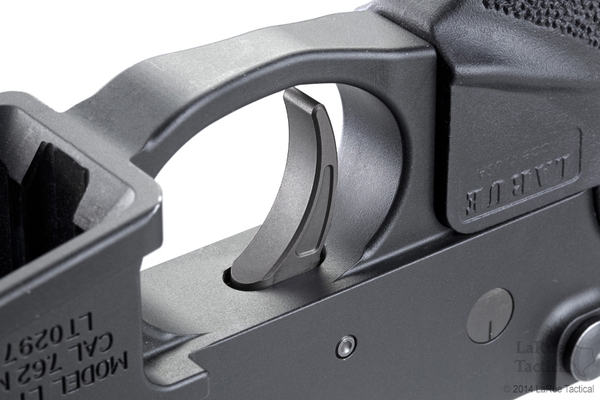

The Larue MBT trigger is greatly reviewer, but has a rather unconventionally shaped trigger shoe.

If you can get past the trigger shoe shape, the Larue trigger is an extremely great buy at about $85

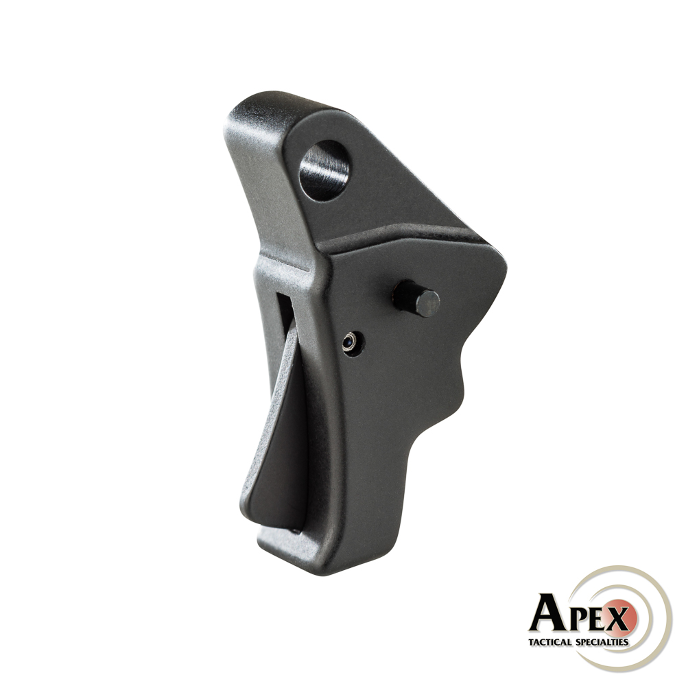

I just went and looked at Larue, looks like a wide flat but curved shoe. I like the wide flat Apex trigger in my Glock.

That or the Larue.....both are great. The Larue has a better break and is made from tool steel. I have one, the only issue is the shape feels different and takes getting used to.
