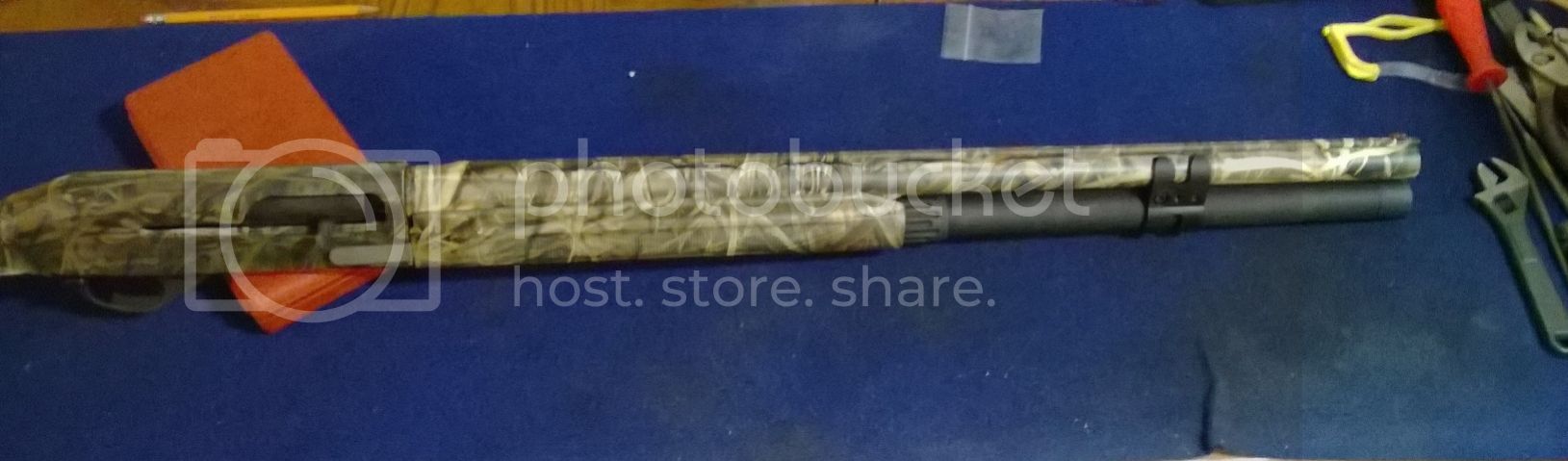

Jesse the I really like the RNT tab. It took a tiny bit of filing to fit it under the handguard and seems to work perfectly. I'll report back after next week's match. I didn't have to do anything to my mag tube to make the extension fit, I know some people have said that they had to do some work to make it fit, but my +6 Nordic tube went right on and gives me 10+1 flush with the 26" barrel.
Nice! How much do you have in that rig?

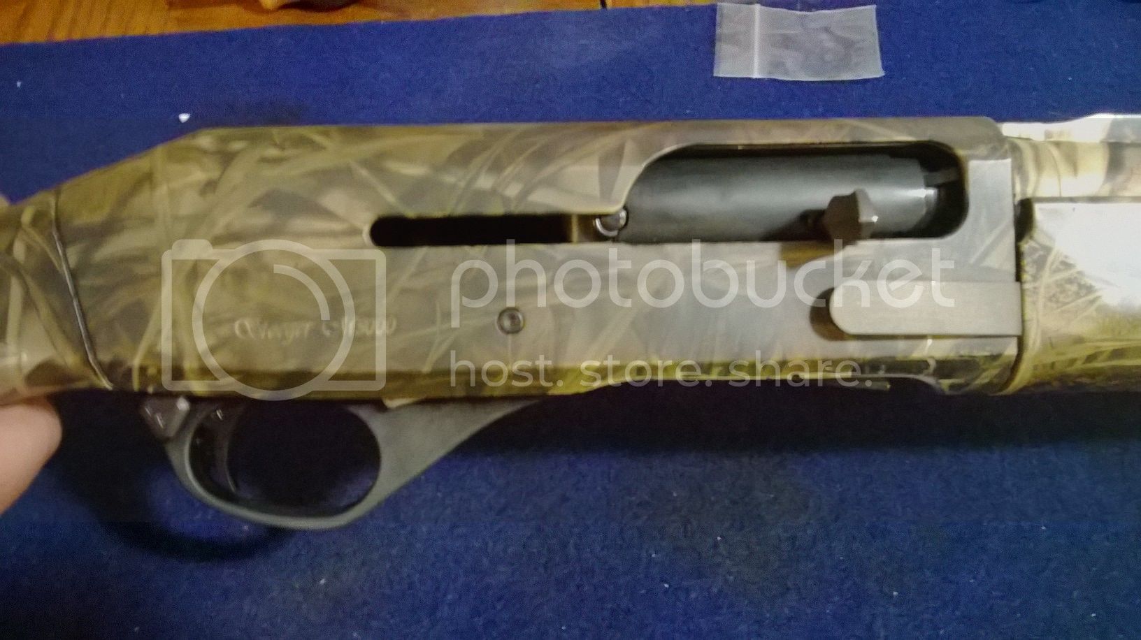

Jesse, can you post a pic of your load port so we can see how far forward you took it? Hard to see in video.

Total, I'm in it $635. I got the gun slightly used off of a friend for $425. Ran 50 rounds of 00 buckshot through it tonight, running shoot 1, load 2, shoot 1 load 2, until the mag was full and then dumping the whole magazine of 10 shells and doing it all over again. It ran flawlessly, and I'm really looking forward to shooting it this season.
Hey Jesse, now I have given up the wasted years weak hand loading I am Taccom all the way, but I need to mod my M2 some more. Its already hogged out a bit but I understand your M2 is stripped clean. Any chance you can post some up close shots of your loading port so I can get an idea how far I can go ??
Thanks mate
Mike
