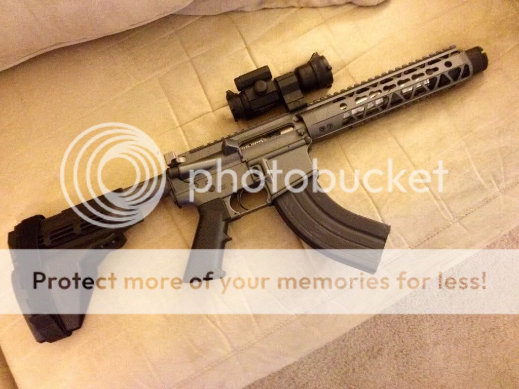

I decided to go the cheaper route and paint it myself.
I'm happy with how it looks but tomorrow I'll find out how it shoots going to Indian Creek in the morning to test it out

7.62x39 AR pistol
Yes the comp is recessed into the handguard.
I did shoot it today and it kicks like an SOB but it's manageable. I did have two reliability issues. One with the ACS mags not feeding on the last two rounds. And the other problem was light strikes on Tula and Red Army ammo.
I'm going to try some different mags. My buddies 6.8 mags worked just fine. I'm also going to modify the firing pin by filing a little bit off the rear shoulder on it.
Not bad for my first AR build I only lost the bolt catch spring during the build but PSA was open so I got another.
