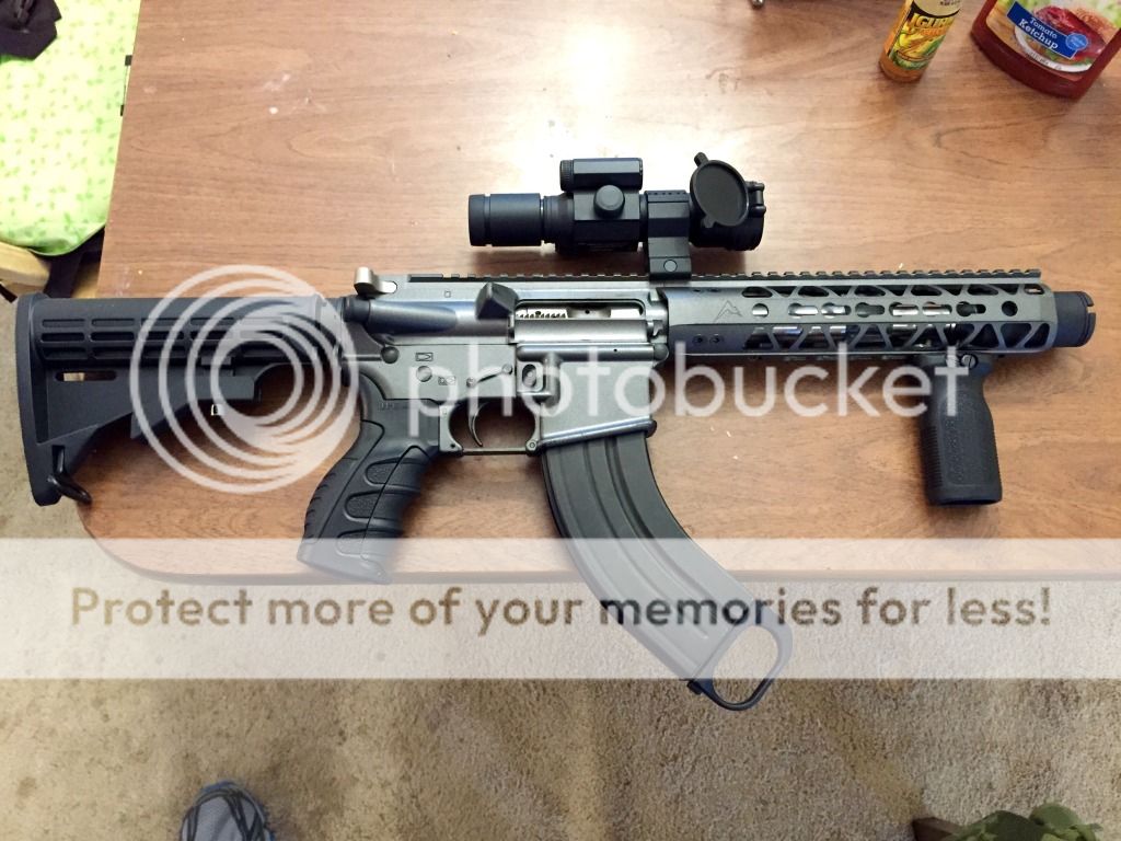

I'm still having feeding problems with the mags.
As for the light strikes I did install a Wolff heavy hammer trigger spring and still had a few lite strikes but not as many. What's your suggestion?
7.62x39 AR pistol
if you work on the firing pin it will weaken it. instead, just below the pin, where the hammer meets the carrier, take of 1/1000 of the carrier so the hammer can move a little farther.
make sense?

Well I still have had some light strikes and mag failures. I was very close to setting the mags out on the range and shooting them as targets because I was getting so pissed at them.
7.62x39 AR pistol
NOooo mister Bill.
i may not have kept up well enough, but you do have a 762x39 bolt, right?
7.62x39 AR pistol
Yes it's a NiB 7.62x39 BCG from a company called Rock City. The magazine issue is real problem that's getting to me. We'll have to get up some time and let you check it out. But when this thing is working its fun to shoot and an absolute cannon.

I got the engraving done and rifle in its final configuration. A buddy is going to give me a Magpul MOE stock to put on it but until then this will work.
7.62x39 AR pistol
Did you get the feeding issues resolved?
I have two SBR AK's in 7.62 but they use regular AK mags and have zero issues.
The long-documented feeding / reliability problems with the AR platform using 7.62 x 39 goes back years and is the main reason why I never considered it a viable option.
7.62x39 AR pistol
It did get better with some new mags but still have the occasional hick up. Tigerstripe suggested I modify the feed ramps which I haven't done yet and I will try but I still want to be able to throw a 5.56 upper on this lower also and it operate too.
