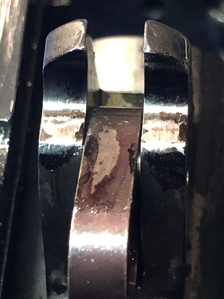

May I ask, what part of the barrel fitting process pertains to better results to the legs? It appears to me being a NOVICE that the legs would be over sized and filed down until the desired fit is obtained?
Joe C
Pass the mustard
Custom Builder
Feb 16, 2018
127
Duke, that is the basic premise. Except no one with any acumen uses files anymore.
DukeSoprano
81
How does that look? It is hard to tell in the pic, all the ink remains on the upper legs and the curves
Joe C
Pass the mustard
Custom Builder
Feb 16, 2018
127
It is not good Duke...but that's just my opinion.
