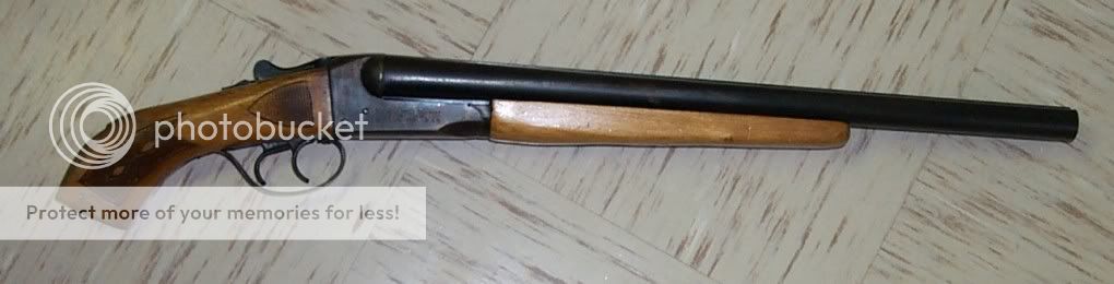

Just make sure that the solider joint between the two barrels is continuous, a few old ones are not. A lot of modern cheaper guns will have a flattened tube, hollow in cross section there. Be prepared to fill the end of this tube with something, or it will look goofy. I used silver solider, but you could use J&B weld.
I am most likely going to be selling mine.
Azrial
Oct 3, 2009
5
Stock?
Nope, I wanted a "Mad Max" when I did the one. I even started working on a leather leg holster, then my attention got pulled away to something else. Maybe I finish it for Halloween and go as Max. It would great to listen to folks compliment me on how real it looked at parties! :twisted:
