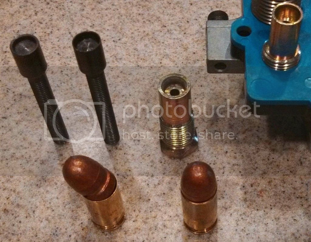

I bet it is the bullet not straight and tilting enough in the case mouth to kiss that side because of the lube groove.
Kind of like the bullet on the left side of this photo, just not as bad.
Take the seat out of the die and take a photo of how the bullet aligns with it. Maybe a modification is in order for it to work correctly with the rather SWC shaped bullets your using.
I'm already using the flat end of the seating plug. Maybe I could use epoxy or something to mold it to the bullet?
I've also read claims that the Mr Bullet Feeder poweder funnel helps the bullet sit straighter in the case.
JMorris
Oct 31, 2011
163
DFW
Depends, that is why I asked for a photo of the relationship between the two.
Note the two "flat" seating stems on the left of the photo I posted, they work for different flat tipped bullets. If your seater allows the bullet tip to go side to side then epoxy might help if you can get it to cure centered or machine it after it is cured, at that point I would just machine the seater correctly into what's there.
