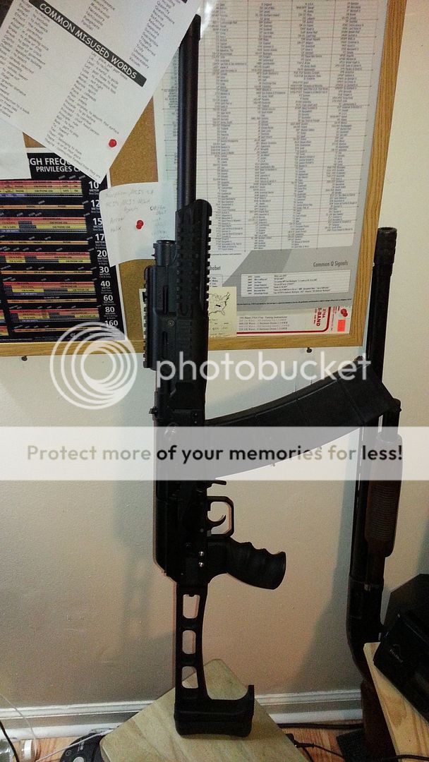

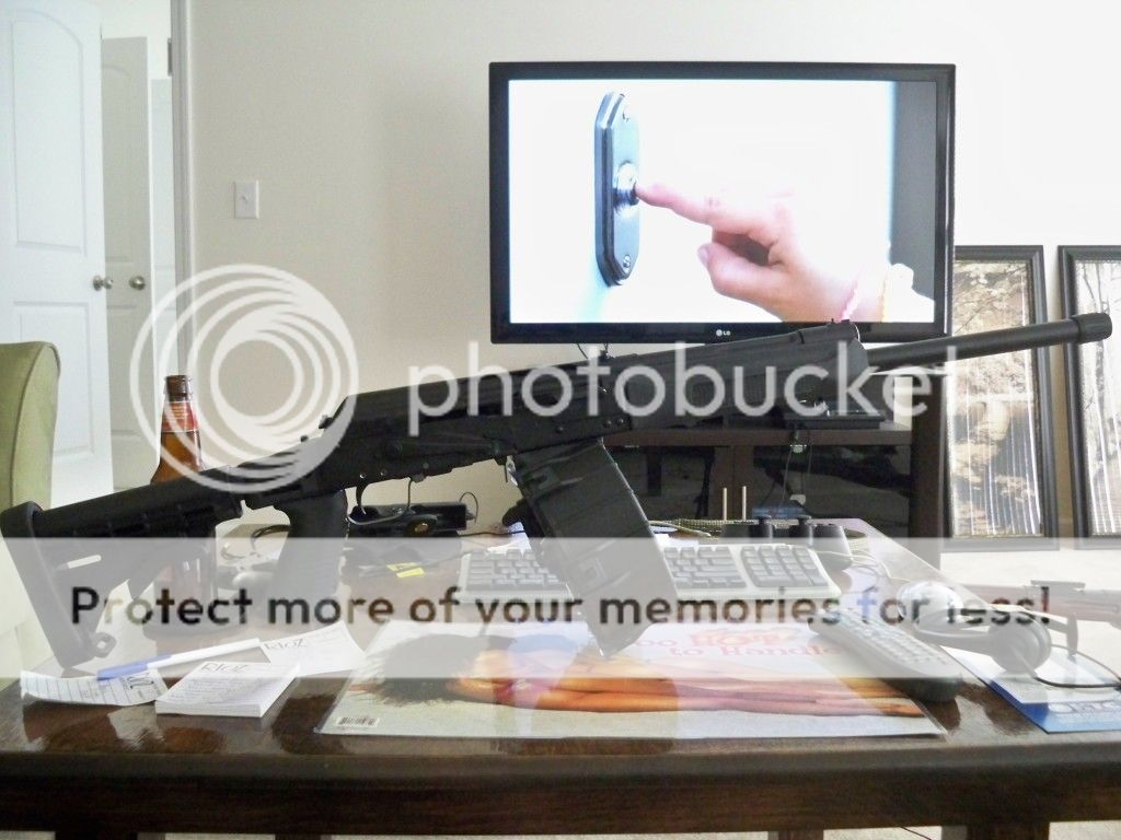

I love mine.
Just for the hell of it, this is my current full collection minus a Taurus Tracker in .357 mag 4 inch barrel.

Wow, enough iron for a small army. I'm a regular on the Saiga-12.com board and I know some of the more enthusiastic owners of this platform will say that the first thing you should do when you get one is "restore" it by moving the trigger forward but personally I don't see it as a "must do" kinda thing. If it runs for you and is comfortable in the import configuration, fine.
I tend to go mod crazy with stuff myself but there's a lot to be said for keeping things simple.
