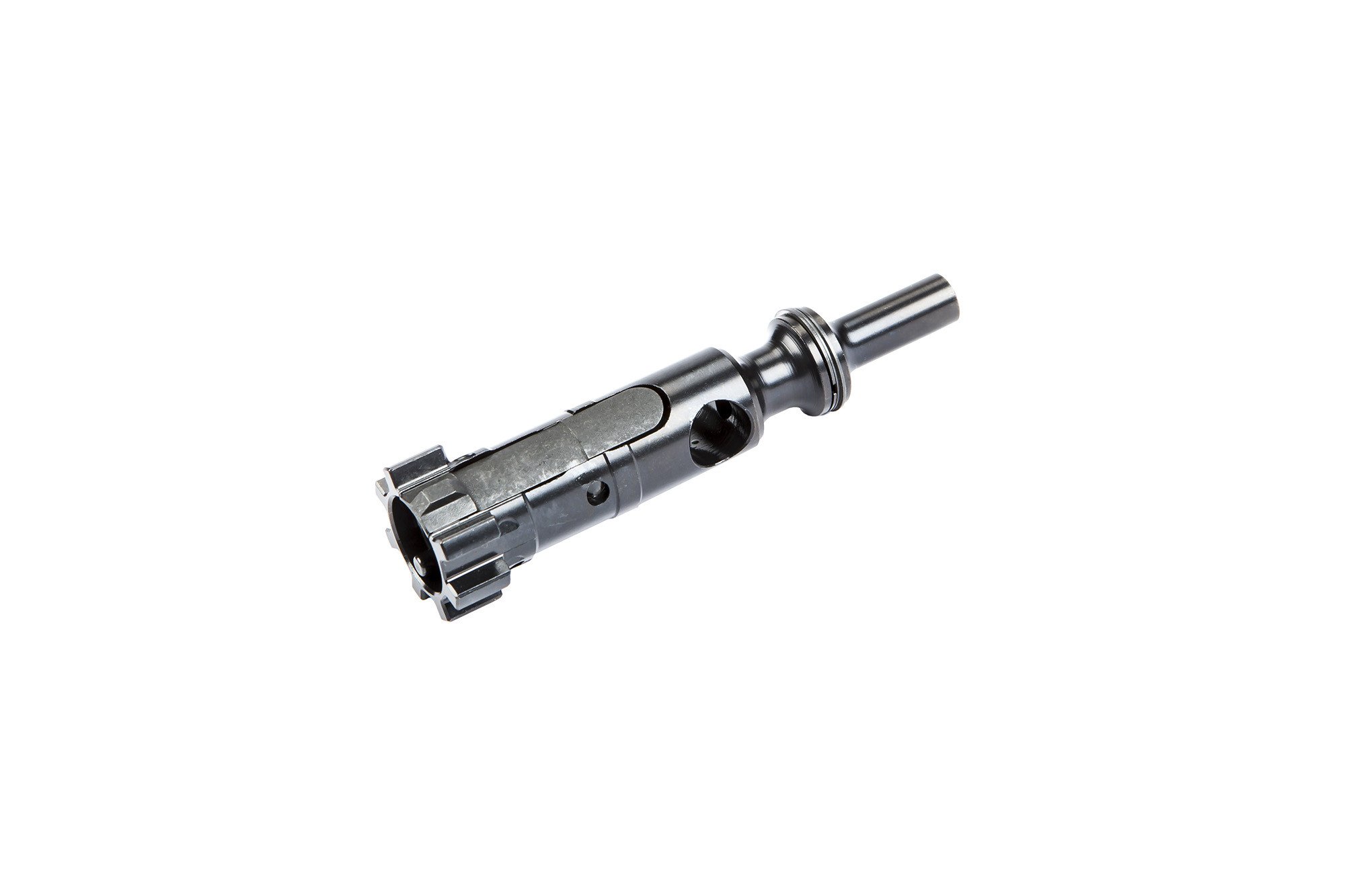

I have decided to stay away for the AR15 in 7,62x39 since the bolt is not really up to dealing with that round. the AR bolts tend to break extractors and lugs it is said with that chambering. The CMMG gun is different but it is an AR10 bolt.

.." the bolt is not really up to dealing with that round."" I wonder what makes you think this ?
I've fired at least 5 hundred rds thru my AR w/o any incidents at all. My upper BCG is made by PSA, so it's got a good warranty, should any problem arise.

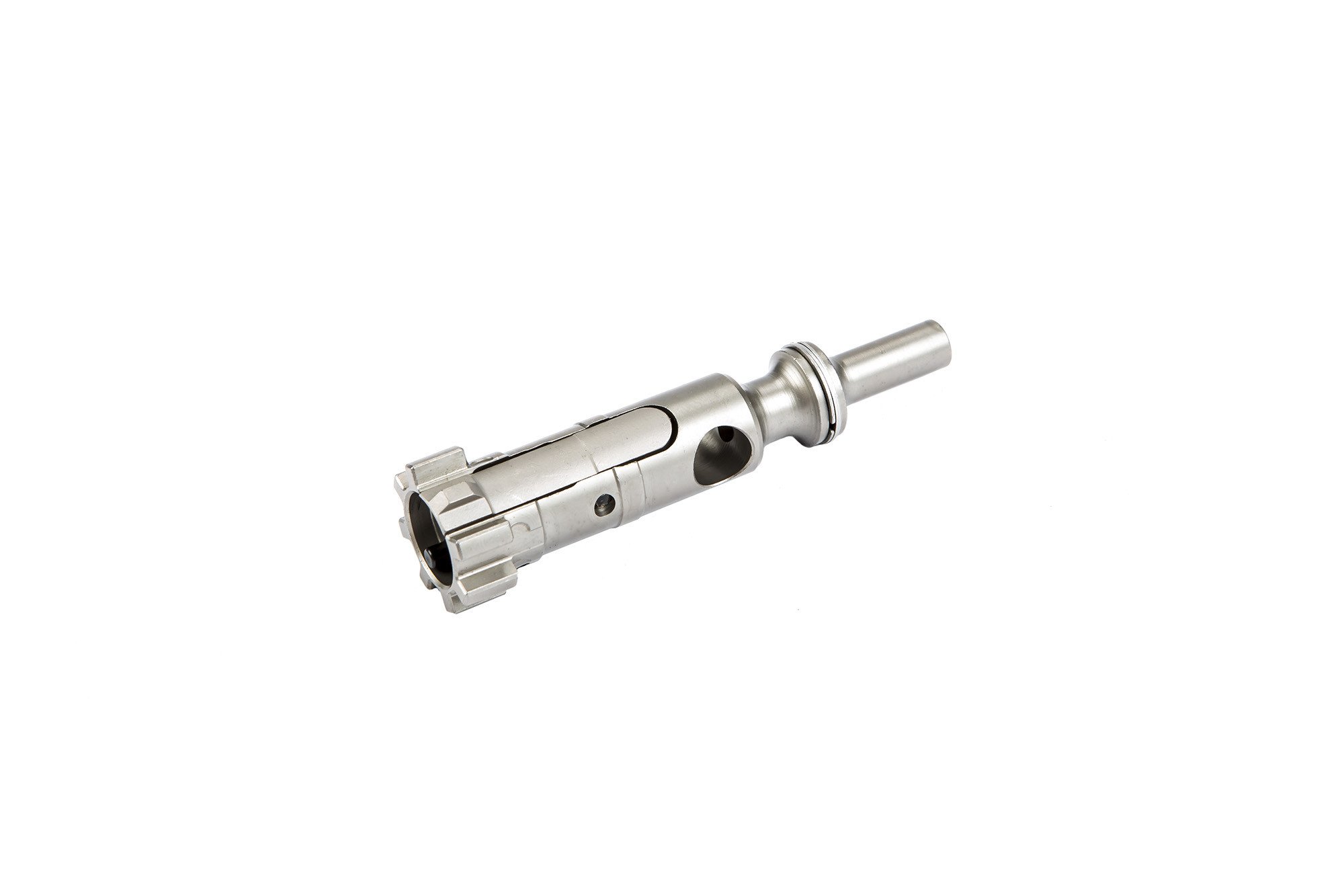

There has been a lot of discussion of this. Many photographs of fail 7.62x39 bolts. A military should be replace like 7-10K. russian bolts break more often. It is enough that I will go to 300 blackout. compare two bolts.
Extractors are prone to break and lugs are said to shear more frequently. It could be your bolt goes 10,000 round or something breaks tomorrow.
What i have done is to add an H3 buffer to my overgassed BCA upper to slow bolt carrier speed and that should prolong extractor life. It was ejecting close to 1 o'clock and now it is at about 5 o'clock. It also feeds better from all after market magazines now.
The LMT ACB has been around for over a decade and has modified lugs that are designed not to break. I have never broken one. I run 7.62x39 in full auto in 7.5 and 8" barrels.
I need to look into the LMT bolt.
Below failed 7.62 x39 bolts

Thanks for posting this information,... I'll keep an eye out for an issue. I usually ckean my AR's more often than most & examine my bolt & associated parts closely My life may be over before I shoot 10K rds. thru my 7.62 X 39 AR. I might shoot 400-500 rds a year,( maybe less )through it. I have had issues with some of the PSA products I've purchased, but will add that the factory did make them right, after some prodding.

The bolt problems is a design issue in that it was made for a smaller cartridge head surface. A lot of material gets cut away. It seems that some say their bolts are better relieved or something or other. The major reason for having an AR upper in 7.62x39 is that I have bit of it purchased from before the biden sanctions ban. I am waiting for someone to make an AR upper in x39 with a AR10 diameter bolt that is compatible with a standard AR lower.
