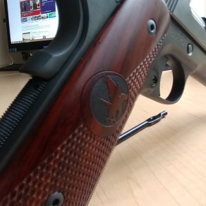

I own a couple of RIA's..
1st is a GI model 9mm.. I wanted to try a 1911 in 9mm, & was going to convert a Colt SS Govt model 45 to 9mm..until I priced the needed parts..
Price for a new slide, barrel, bushing, mag, etc.. exceeded the price (then) of a complete GT model RIA in 9mm (at the time).
This must have been shortly after RIA's were being sold here....the only RIA 1911 chambered in 9mm offered @ the time, was their GI model.
If functioned flawlessly. Didn't like the GI sights, so had Heinie straight 8's installed. changed a few things, had it cerecoated a matte silver as I didn't like parkerized finish. Looks like this:RIA 9mm 5 L.JPG
joepistol
Apr 23, 2020
1,126
Rochester Hills, Mi
other RIA was one of their Officer sized 45's....think RIA calls it the "CS "model.. comes w/ a bull-type, bushingless barrel.
Mine's an older model than the CS model currently shown on their website. My older CS came with the small GI style sights .
I bought it "previously owned".. but it was un fired.. Guy bought it on impulse & never fired it, sold it to me.
I tried all types of ammo in it, as I wanted to see if what I'd read was true.. (that smaller than Cmdr.-sized 1911's weren't reliable.)
I was impressed with the accuracy of this short barreled 1911, even using the small GI sights..I could shoot it better than I thought possible.
I discovered that my 230 gr cast RN hand loads wouldn't feed properly.. They hung up.., needed a push on the rear of the slide to close completely.
Took it to my gunsmith for his opinion. He measured the chamber, then my loads. Seems cast lead bullets are about .001"larger in dia then FMJ 230 gr pills.
He used a chamber reamer & made about 1 turn with it, to open the front of my barrel chamber slightly.
It now feeds perfectly.
Reading the RIA owner's manual, it states to use 230gr FMJ loads only in this pistol....so I can't fault the pistol for my issue.
Both the RIA 1911's I own have not been fussy shooting my handloads ( I shoot my handloads exclusively)
I've loaded 100 gr, 115, 120, 124, 125,135, & 147gr bullets in my 9mm..some are cast, polymer coated, FMJ, & JHPs
in my 45's I've loaded 155, 185 , 200, 230gr cast, coated, FMJ & JHP's.Ria 45 Compact L.JPG
