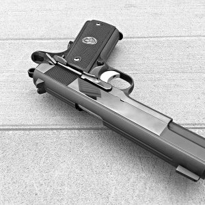

too tight in the slide, just need to take a .001 off and it should be good to go
Nothing wrong with a tight bushing. It will loosen over time
What did you use to measure the ID of the slide?
I’m looking for a good inside micrometer.
Calipers usually are not the best approach to measuring the ID of a round hole.for reloading i use a cabellas digital, for other stuff where i'm looking for accuracy i have a 6" Mitutoyo and an 8" Spi, both dial. the Mitutoyo is my go to
Then how did you know you needed to take .001 off the bushing?i'm not measuring the slide, i don't do tool work on the slide or frame, i adjust my small parts to fit the slide and frame
