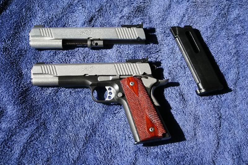

I bought a Kimber Target Elite II back in 2002. It had a great trigger. I usually don't even measure the trigger break till a pistol has had at least a couple hundred rounds through it. With this guy I took it home and immediately got out the Lyman digital gauge. The trigger broke at 3.4 lbs. After a couple thousand rounds of 45ACP I was shooting it one day and it doubled. I stopped shooting it, took it home and found out the still wonderful trigger now broke at 2.3 lbs. Yes, I could have fixed it but I decided to use it as the bottom for 22cal conversion units. Below with a Kimber unit and if I had that to do over I would have ordered the blued not silver Kimber conversion unit.
Anyway a few years ago a shooty buddy wanted it and I sold it to him, but he did not want the 22 conversion, which is O.K. as I have other bottoms to use with it.
