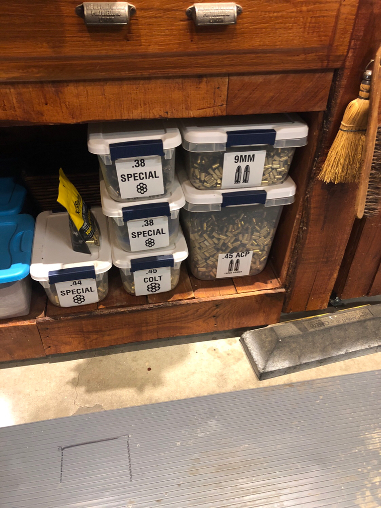

I currently load 9mm, 38 Super, 45 ACP for the semis, and 38 Special, 44 Special, and 45 Auto Rim (for my wheel guns). I’m utilizing (2) Dillion progressives (RL450 & RL550), (2) Lee Pro 1000, and a very old c. 1960s Lyman single stage. I find this hobbie (almost) as enjoyable as shooting. Very therapeutic, quality (me time) out in my shop! I highly recommend you jump back in with both feet Greg, after you get settled into your new digs!

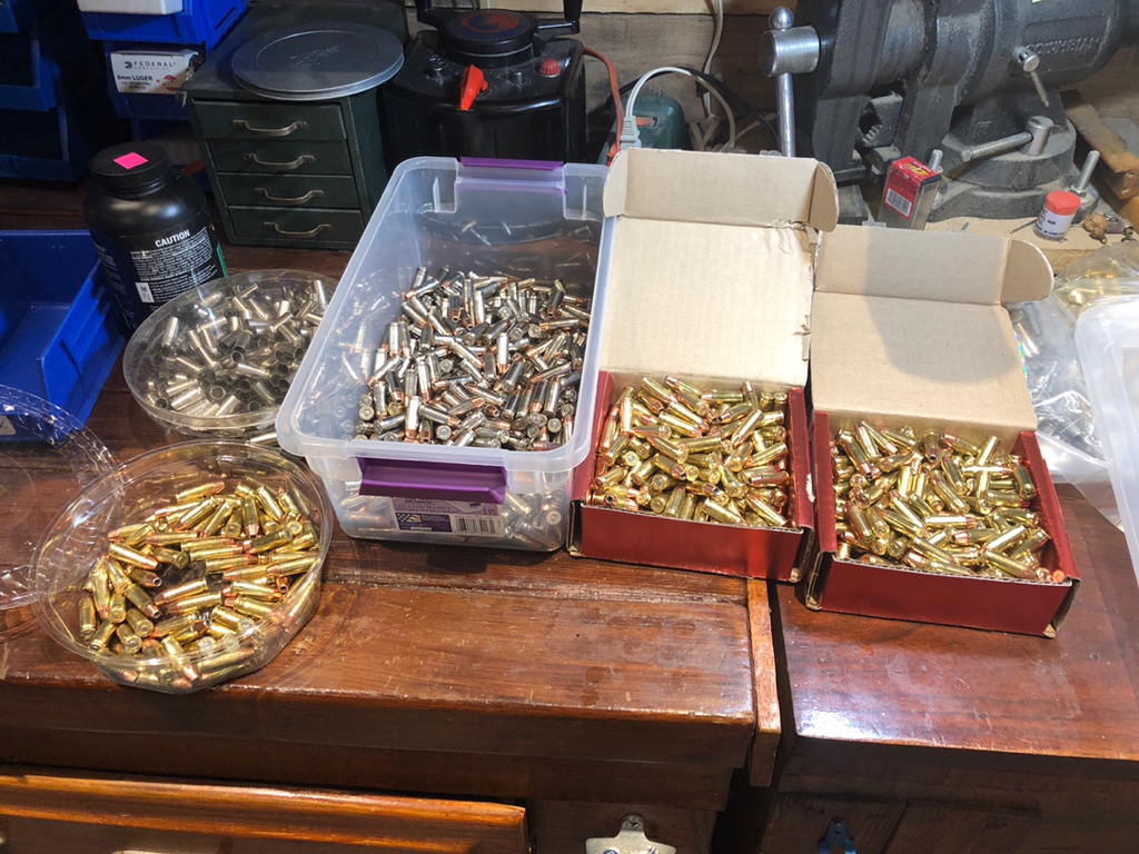

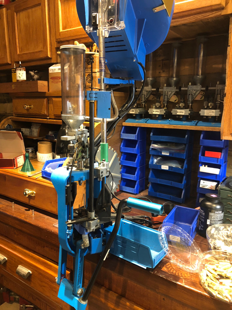

Yesterday’s 38 Super.....and my set up

It is a very rewarding hobby and I sure there are a lot of people here to help anyone get started. My advice is go with a Dillon 650 and start by reloading a revolver cartridge.
My biggest problem is I love trying new loads!
