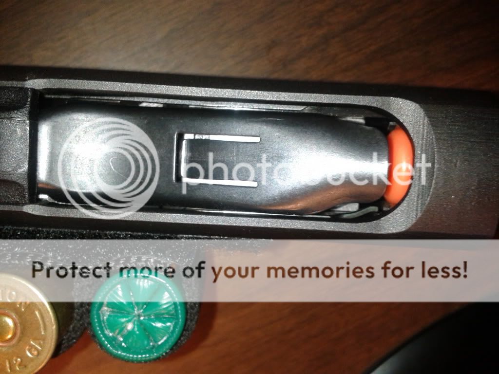

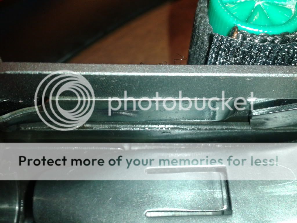

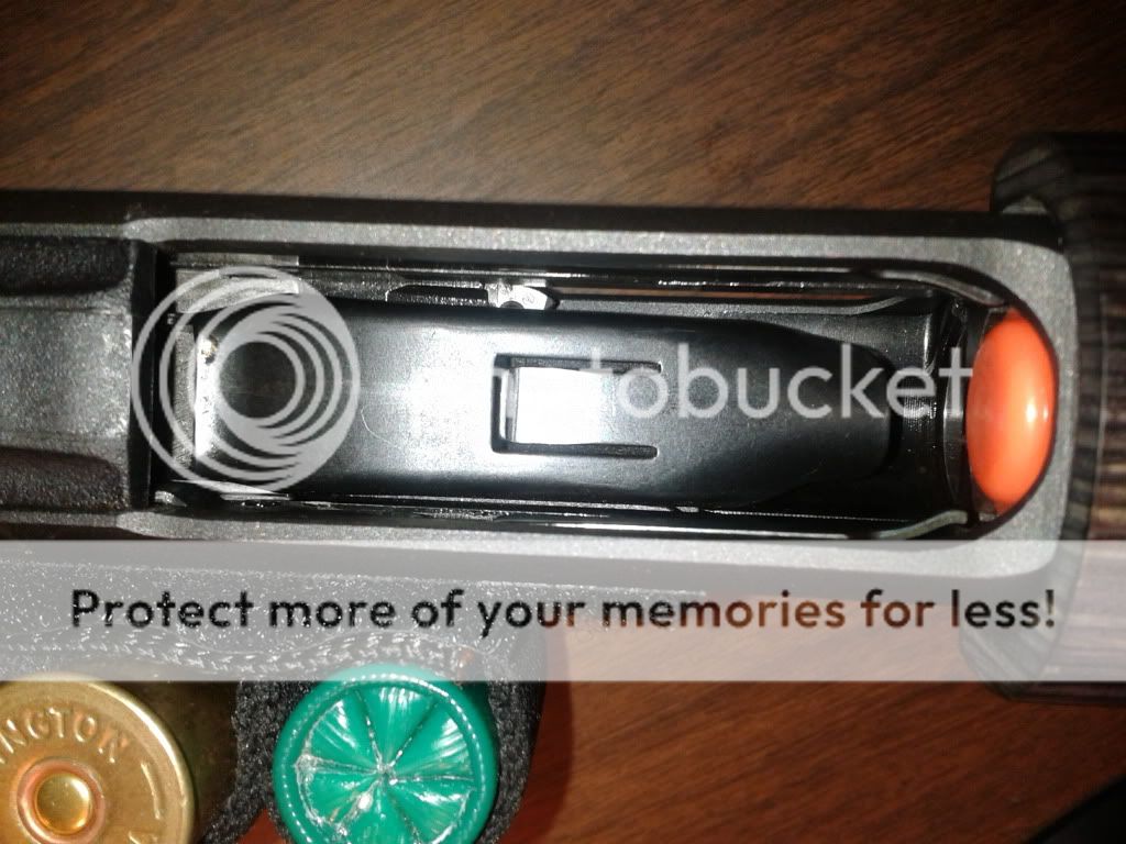

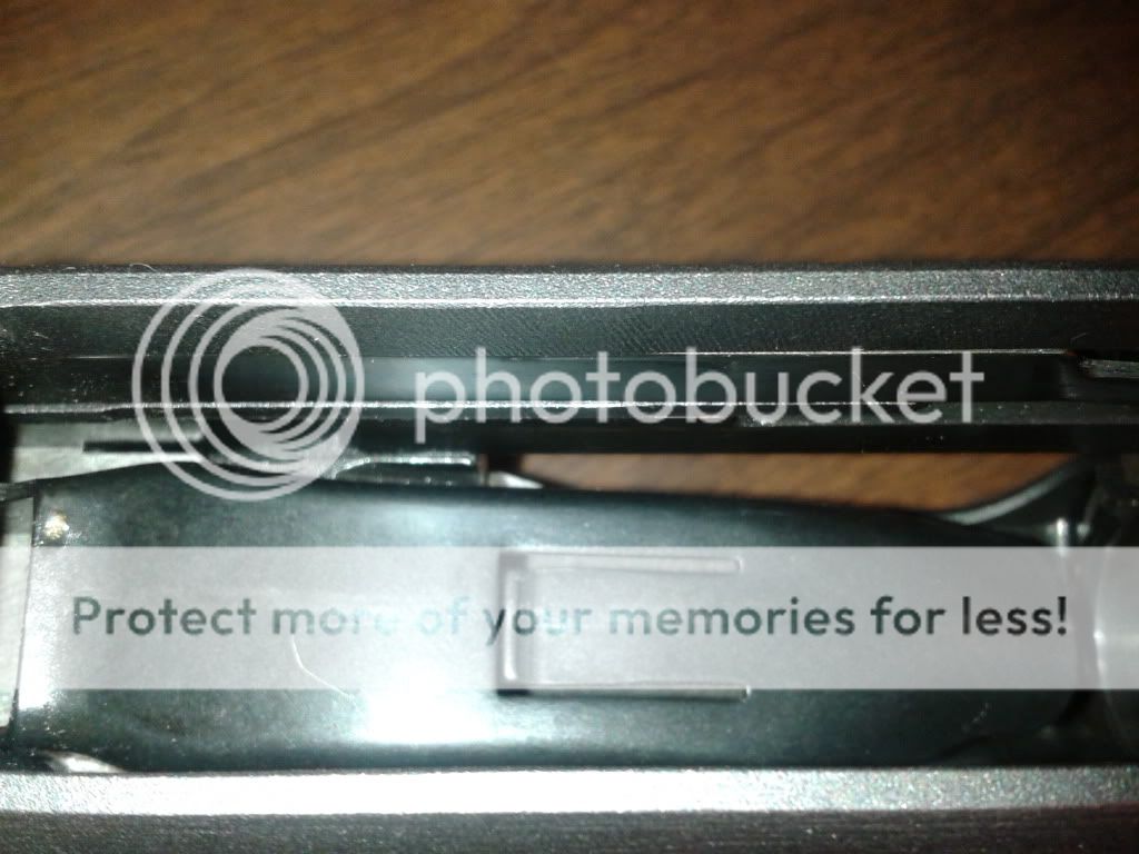

shootingbuff
Oct 4, 2010
1,296
Lawton, OK
Nova x 2. Sorry for the sideways pic. Looks right on my phone. When the lifter is pushed up it stays up and there is nothing but empty hole.
