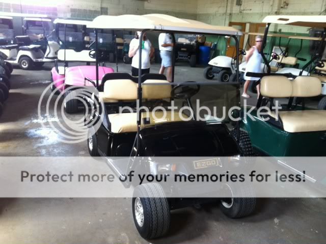

I am currently "hooking up" a 07 EZ go TXT series electric cart.
so far,
5"lift
12"wheels
22"tires
marine radio and speakers
rear flip seat
Getting ready to upgrade the electronics to get more power flow and better speed
mcdaniel
Jan 14, 2010
560
Greenville, SC
The speed chips are nice if you have a PDS ezgo, since I have a series, which has a simpler system, I cant use a chip. The ease of modification is easier however. I do not have regenerative braking- that is the biggest difference. It allows me to modify my cart easier.
Here is my cart when i dropped it off- (I'll post new ones when i get her back)
