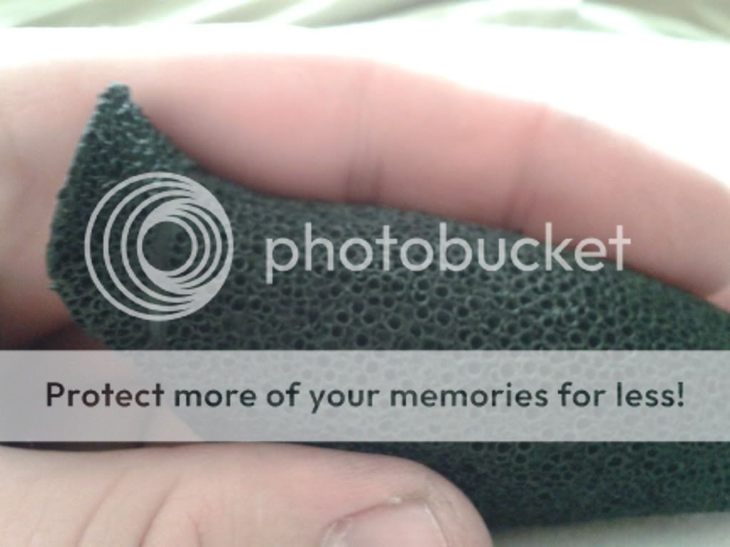

So I found a use for this extra soildering iron I got for christmas. Its just been sitting around in its package not being used. So I ordered a couple of large backstraps for my m&p. When they got to the house I fired up the iron and went to town on a few household items like the soildering iron base and a knife sharpener and who knows what else... Then I went after the grips and this is the result.
This one I put 85 rounds through and am very happy with its result..and I like the tan on a black gun... her it is..
More to come just gotta sneak the kitchen knives out without getting caught.

Looks great! Stone has been messing with ours & he's stipples every "toy" firearm in the house. Have almost decided to let him have a real one. Question. Did your iron come with the flat tool? Yours had a great look with both textures mixed! Wonder if I can get the flat attachment separately? JS
My soildering iron was bought at harbor freight (super cheap) and has the slip in head.. I have yet to look for other heads but what I did do is fill the tip to a sharp point because before it had a bit of a flat point. I thing harbor freight sells other heads but I think they might be the screw in heads... on the side you don't see on the tan one I actuly put vertical lines but I didn't like them so I smoothed the out and re stippled the.. I think that only worked as well as it did because these grips are relitively soft and rubbery. I will check at harbor freight today as I'm going back to town with the family in a few hours.
I alos have a set of taps and dies so I bet you could thread a bar with those... but its not needed in my case.

Start with gun parts like removable grips or ar15 grips stuff you can get for cheap like these were a couple of dollars a peice so I ordered a few as to not mess up the originals. Heck I tried to make nice lines on the left side of the tan one which didn't work out so I smoothed it back out and stippled it. And it still turned out pretty good.... if all else fails get you a high point or a cheap plastic shotgun lol
