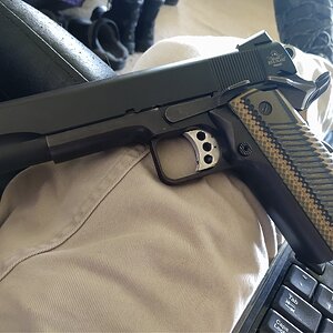

Looks like the aftermarket hammers are 2 position only.
Am I the only one that sees a safety issue with this?
Did want to add a beavertail and commander hammer to a Mil Spec, hammer bite getting old.

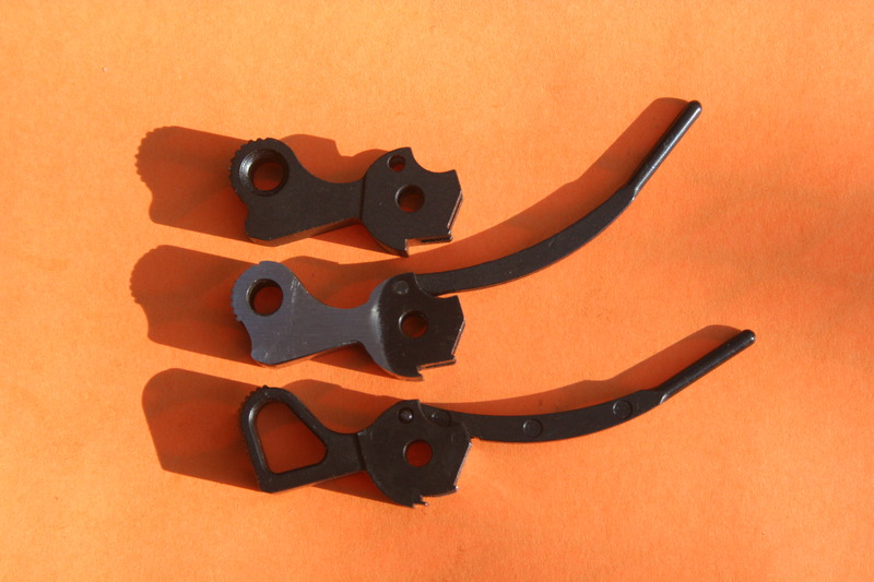

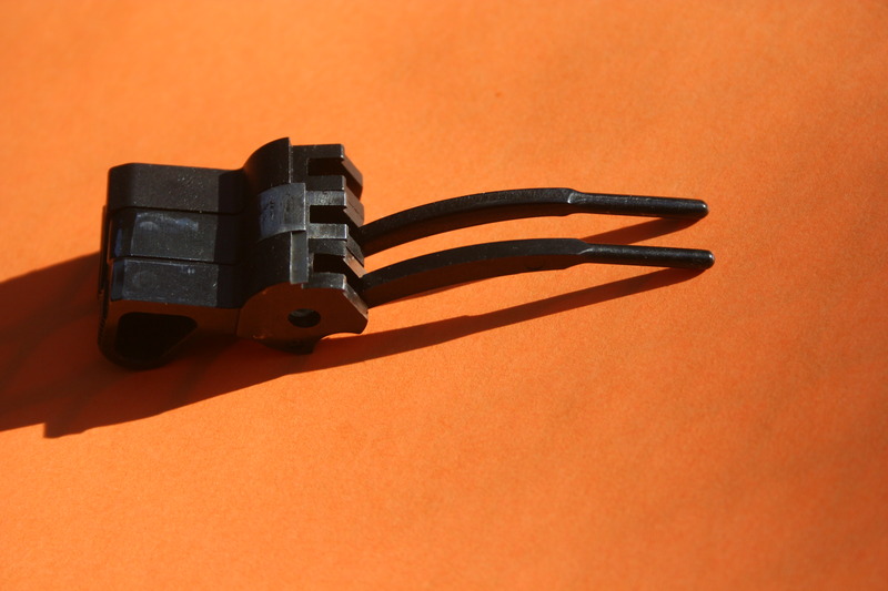

The SA 3 position hammer is sort of unusual. Below on top is a Colt hammer with the quarter shelf. Know you have that if you pull the hammer back and it stays but drops when you pull the trigger which does not happen with a half cock position. In the middle a Colt hammer with a half cock. On the bottom a SA hammer (out of a RO) with both the quarter shelf and half cock.
And another view of the three hammers in the same order.....
The quarter shelf hammers have nothing to do with a Series 80 mechanical firing pin safety. Colt also uses them on many of their pistols with no mechanical firing pin safety. Also other manufacturers which use the Series 80 mechanical firing pin safety do have a true half cock.
