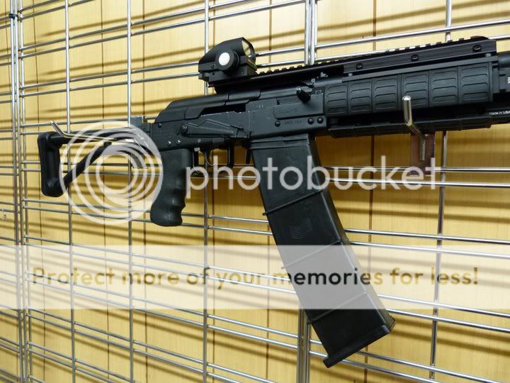

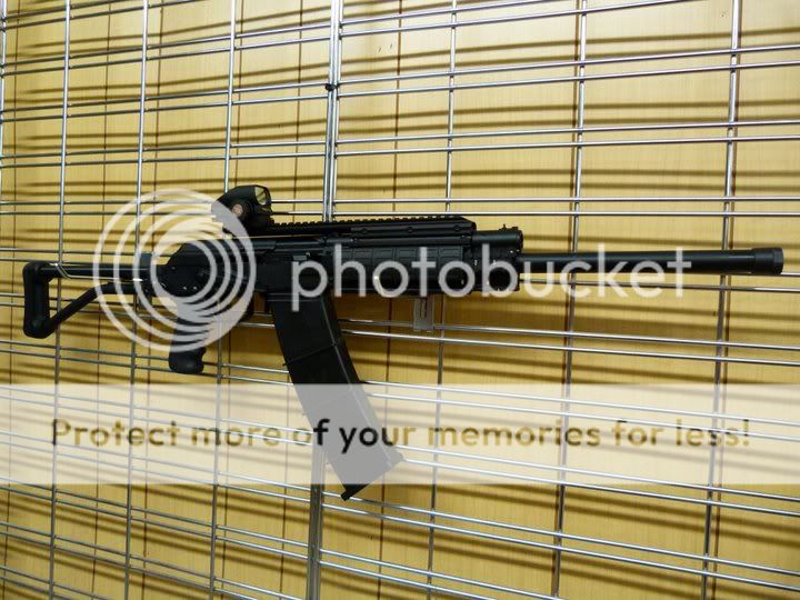

Heres an example of the Saiga conversions were doing at the shop. I'm not really the shotgun type, but they're fun to do and look cool as hell.

Do you leave the bolt hold open device intack or remove it??
I've seen a few of these before & with the factory style hammer/trigger & trigger guard moved forward they are much nicer than they are as they come..
Is that an Ace Folder Stock??
Looks Great!@!

Midnight Raver, I put this one together for a customer. I've been trying to talk the boss into building one for the shop
Glock 17L, That is an ACE stock with the folding mechanism. I keep the bolt lock in but I modify it slightly so the spring on it will stay put. I also move the trigger group and grip forward utilizing a tromix fire control group,a new trigger guard and Houge grip. Of course I touched up the finish on the bottom also. The quadrail is a UTG and fits like a charm with no modification needed.
