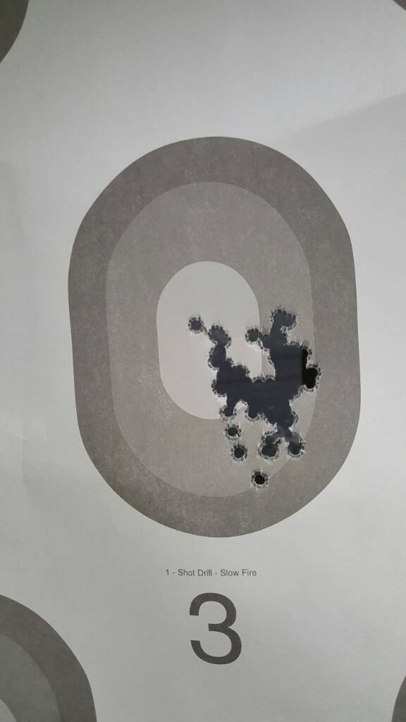

I went to re-confirm my zero today after swapping out my diode to a larger MOA. My zero is a little off, I'd have adjusted it but I forgot my screw driver. Anyway, this was 50rnds at 20yrds unsupported.

Just zeroed my MPX at 15 yards with a holosun 510c (eotech knock offf) and moved back to 25. Sure as ****! I was just catching thevtop of the head box. So I dialed the zero in at 18 yards to bring the 25 yard hits down a little. Here are the results. I'm starting to think a 25 yard zero maybe where it's at.
