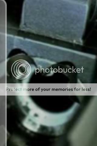

Okay so I put a Rainier Arms 18" SPR barrel on my Mega upper and took it to the range for the first time yesterday. I didn't have any malfunctions after tuning the JP gas block but noticed this on ejected rounds I didn't fire. Here's a few I cycled through after I got home.... I realize I could probably easily fix this myself with some smoothing, but I'd rather have Rainier fix it if its something that came from them. Here are some pics...
On rounds cycled by firing, the bullet has two bilateral gouges which I think originate from the difference in the base of the barrel feed ramps and that of the upper.
What do ya'll think? I appreciate any help
(Side note: the barrel has M4 feed ramps, and the upper is supposed to work with any barrel. Two of the bullets have been pushed back into the case by getting caught on the ramps from manually cycling to provide examples of the damage to the bullet.)

No problem, that's normal. They're not getting scratched on the way in, they're getting scratched on the extension lugs when you extract them. Every AR should do this.

Sorry, I was rocking some speed reading and completely skipped that part. Those rounds do appear to be pushed in more than I would consider normal (I think any pushing in is abnormal on an AR, but I don't know that for a fact.) At a glance of your picture, it appears that you have rifle feed ramps on the barrel extension and m4 feed ramps on the upper which is kind of a no-no. Check out this image for me and verify if that's what's going on. It could probably be fixed rather handily with a dremel, but that's probably not what you want to do.

my m4 ramps look like this. I don't know if it makes a difference but yours don't look like they are lined up properly? Alright everybody check your rifles!

It looks like an M4 Extension to me.

The website says the extensions are M4, but they clearly don't line up... I think the ones that are pushed back were from me manually cycling the bolt and it not having enough force to chamber the first "try". From the rounds cycled by firing, I don't think the feed ramps are an issue now knowing those gouges are from the lugs on exit. But I still wish the extensions lined up, dont really know what to do since everything seems to be working fine otherwise.

Also, i manually chambered a round by using my finger and the bullet doesnt even come close to contacting the bottom of the extension where there is a difference in contour, so I don't think its something I should worry about
