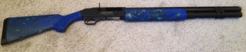

My new shotgun.
Mossy 930 Patrick Flanagan, added a 22 inch Jerry Miculek barrel, plus 4 magtube and Choate combat bolt handle.
I'm planning on shooting it in the tactical division at the NRA TPC in San Antonio, November 3rd.

Looks good. How does it differ from a JM Pro besides the color and charging handle?

As far as I can tell other than barrel, mag tube and color, the Rhythm and JM are the same.
I finaly shot about 200 rounds throught it this weekend. It shoots sweet and smooth, but was kind of fickle about some old (I mean OLD...even paper hulls) ammo.
And slugs at 40 yard were high and right about 6 inches.
I guess I will stick with the patrol division and my 870 in San Antonio, until I can find some slugs it will put dead center.

I put the large shim in the buttstock to bring it down so I could get my face low enough to see the front sight only. Also I took off the barrel clamp. After doing that the gun shoots point of aim at about 50yds. try those two things first. I shoot Fiocchi low recoil slugs.

Well, I will try some different slugs before making any changes. I was using some Federal slugs my department has had for quite awhile.
I will be on the range running qualifications all next week, so I'll shoot it some at lunch, and see if I can get different results.
I had forgot about the shims too, until you said that. Good thing I never throw my boxes away haha.

I was having trouble getting my face low enough to see the sight only. I was seeing what looked like a landing strip on the vent rib instead of just the front sight. Large shim cured this. In turn getting my face in the right position lowered my point of aim/impact.

added the .250 drop shim. Yeah...I like that much better. Straight line of sight down the top of the rib now. Thanks
