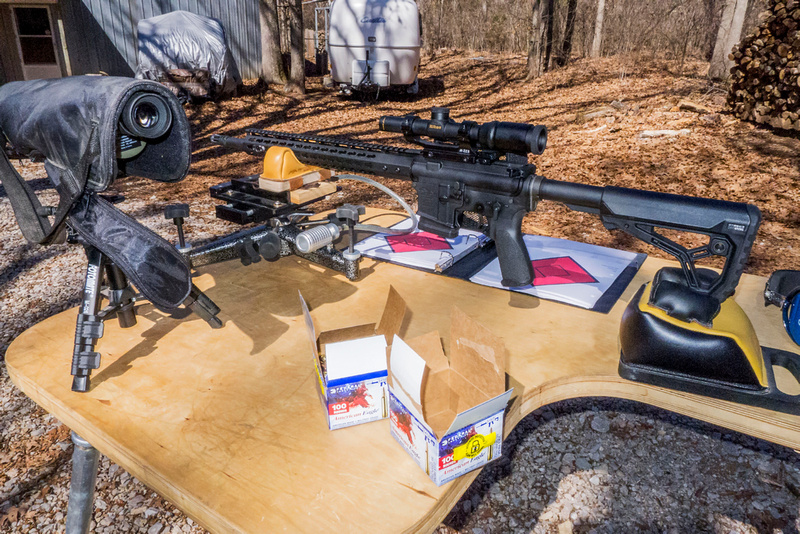

give us a rundown of the gun & sighting system, maybe the problem isn't you.
Anderson upper and lower. Heller Enterprises Tactical, 18" Stainless Steel, EV5 (Polygonal) barrel with 5.56/WYLDE chamber and adjustable gas block. HyperFire EDT2 trigger. Nikon Africa 1-4 scope. (I've got a Nikon 4-12x40 on the way)
Right now I'm shooting off the bench with a target benchrest up front with a BumbleBee bag in the rear. This barrel is brand new, only having 70 rounds run down it. I'm shooting American Eagle .223 right now while waiting for bullets I've ordered from Sierra. Greg Lamb has been working with me from afar, but I believe I need some one-on-one help, if even just for one afternoon. While my primary concern is bench, I know I don't have a clue how to shoot this thing off-hand.
Here's the reason I'm disappointed:
That's a 4.25" group at 100 yds off the setup in the first picture. I'm a bench shooter and not used to groups like that! Greg says it looks like any one of four things he can think might be causing me problems, without actually watching me shoot. First the barrel probably hasn't settled in yet. Second, American Eagles aren't as accurate as my reloads. (I was shooting under 2" groups with my OEM 16" barrel after just 200 rounds through it.) Third, a 4X scope isn't the best for 100 yd work. Forth, my trigger isn't really all that good for target shooting.
So should I just quit fretting and keep shooting to let everything settle in or does something stand out as glaringly incorrect?
Did you assemble the rifle? What bolt carrier are you using? I’ve built 4 or 5 rifles now and all of them have performed better than what yours is doing. It sounds like you are an experienced rifle shooter so I doubt that technique is a real issue for you. My first thoughts are something with the build being out of spec, either the assembly or the parts.
What's the twist rate of your barrel? Have you tired different ammo, specifically a different bullet weight? My first barrel was like that, but twice as bad. I couldn't group better than 10" @ 100 yards. Had a guy that's more "seasoned" that myself look, and said it was my barrel. I could either shoot heavier bullets, or swap barrels. I swapped the barrel and it's been a tack driver.

Sorry 'bout dat! The twist rate is 1:8. Anderson OEM BCG. Homer, in Moore installed the new barrel, adjustable gas block and handguard so I'm not concerned with a botched gunsmith job.
As I mentioned, the target shown was shot with the standard plinking round from American Eagle. However, I had previously shot 2" and smaller groups with the 16" OEM barrel with a 55 gr FMJ bullet from RMR over various weights of TAC. However, I've got 400 Sierra 63 gr semi-point SP bullets being delivered by UPS any minute and I'll be loading those with H322. Maybe I'm just getting ahead of myself with the frustration bit. I'll get these rounds loaded and get this barrel to settle in a little better before I complain further.

With that 1:8, I'd be shooting heavier bullets although some run 55 grain in that twist with no issues.
Different loads and a decent trigger is where I'd start.

I just took my trigger apart and inspected it with a 40X jeweler's loupe. At that magnification I could easily see the problem. I should have sent it back for an exchange, but I've done enough trigger jobs in my life I just touched it up myself. Can't wait to actually put it to a target. It's smooth and has a glass break. Very pleased, but the proof will be in the targets.
I've got a 1:9 that shoots Hornady bulk 55 FMJBT at 1.25 MOA. My DPMS barrel shoots them right at 1 MOA. I'm betting barrel.
Well, I got the barrel "settled in", installed the Buckmaster 4-12x40 scope and got away from the factory ammo and pulled my trigger and did some proper polishing. Shot a .500" group this past Wednesday when the wind was down. New barrel, gritty trigger, couldn't see the target and better ammo was the crux of the problem. My .500" group was shot with a 69 gr Sierra Match King over 22.2 gr IMR8208XBR with a CCI41 primer. Oh, and the OAL was 2.314". Had to buy an ASC magazine that would hold ammo that long.
