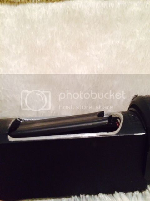

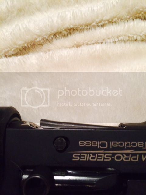

Here are a couple of pics of mine. Non loading port side I went all the way down to the angled area. Loading port side I went down until I was about to hit the pin for the carrier latch. Front I rounded off so it no longer says Mossberg 930. Last 2 pics are older, I went down a little farther since those pics. Top pic is final product. I can get more pics tomorrow. Gun is in the safe and the wife is asleep.

No problem. As Matt said, take your time and go slow. I actually did mine in 4 different sessions. Took some off, tried it out, and then took some more off. Happened over about 5 or 6 months before I got it were a realy liked it. Most of the guys I shoot with didn't go as far as me, but I have huge hands so taking off more helps me. I used a file to do all of the trimming and only used a dremel with a sanding disk to smooth things out.
