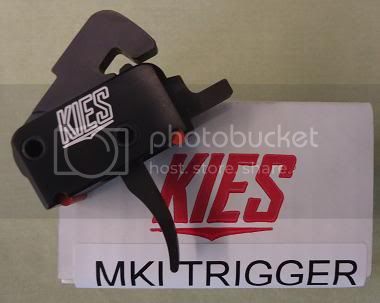

Drop in modular design set at 4.5 pounds of trigger pull.
- Full power hammer spring
- Reliably detonate hard primer military .308 ammunition
- Suitable for use in AR-10 type rifles
- Service rifle competition legal
- Anti walk pins included
I Got one of these KIES triggers From Joe bob outfitters. It is a modular single stage trigger, that has a pull average of 4.5 pounds
I took out the old trigger parts and dropped this one in Had to do no fitting pins went right in place. The trigger pull is so much cleaner and lighter then the stock trigger. I shot it at the last rifle match and used military ammo, I did not have 1 round not fire. This is a very nice trigger and anyone is welcome to try it out on mine. If you’re looking for a new trigger I would highly recommend the KIES 4.5 trigger.

Ryan, just ordered this trigger myself to go into a Spike's lower. Did you happen to drop yours in a Spike's lower? If so did you not have to remove the safety or anything to fit. Thanks.
Walter
I put mine in the palmetto arms lower we did in the group buy. I did have to take the safety out to get it in but then put the safety right back in.

Aggieddad02
Sep 30, 2010
304
Alexandria, LA
