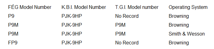

I know feg made da hipo clones, but maybe they made single action ones as well? You sure its a DA? Not too up on the platform.
Yes, it was a double action. When I pulled the trigger the hammer would rooster and fall. Just didn't fall all the way.
something about a double action Hi Power just seems wrong.
It is wrong. True Browning patent High Powers are all single action.
However, FEG made some 'Mules" that looked like a Hi Po, but had S&W style internals.
They thoughtfully put the same model numbers on both types. :banghead:
