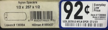

  • Trigger - Here's where you'll probably want to invest some time and make some decisions. Since it is a bullpup, there is a trigger bar and an additional spring which will increase the pull weight of your trigger. I sent my stock trigger to brimstone gunsmithing and had the pull weight reduced to about 3lbs. Also, I added a nylon bushing, see pic below, to remove the take-up from the trigger. (I copied that idea from another person, so I take no credit for that.) The manual states that altering the stock Ruger trigger or the trigger parts on the stock could make the rifle more dangerous. I also used some silicone spray on the trigger bar to make it as smooth and frictionless as possible.
  • View attachment 5466View attachment 5465View attachment 5464
