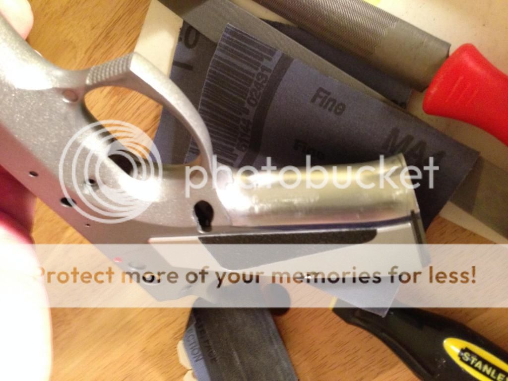

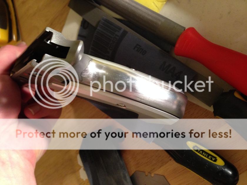

I finally got around to removing the waffling. I've been working on it a few nights. Started with files and have moved to emery cloth. Still have a ways to go. I'm undecided on whether or not to checker it. I have the files and a guide someone machined. I tried it on a piece of pipe and while I wasn't trying very hard the results were ugly! Will try again on the pipe this time a little more focused and see how I do. If I decide not to checker it I'll take Mike's first suggestion of grip tape after I have it refinished. This was my first use of Dykem. Works well.
It's been very time consuming just to remove the waffling. If one were to undercut the trigger guard a bit, what would be the best method to use?
