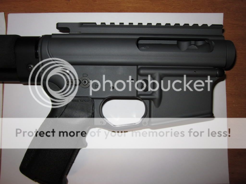

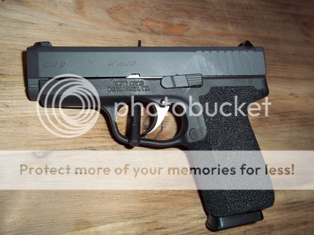

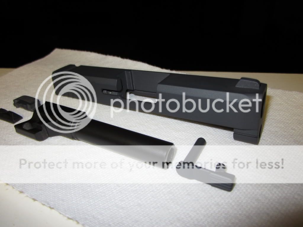

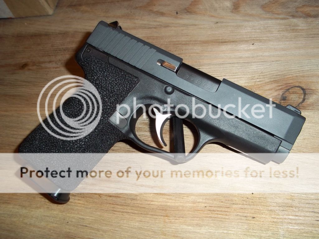

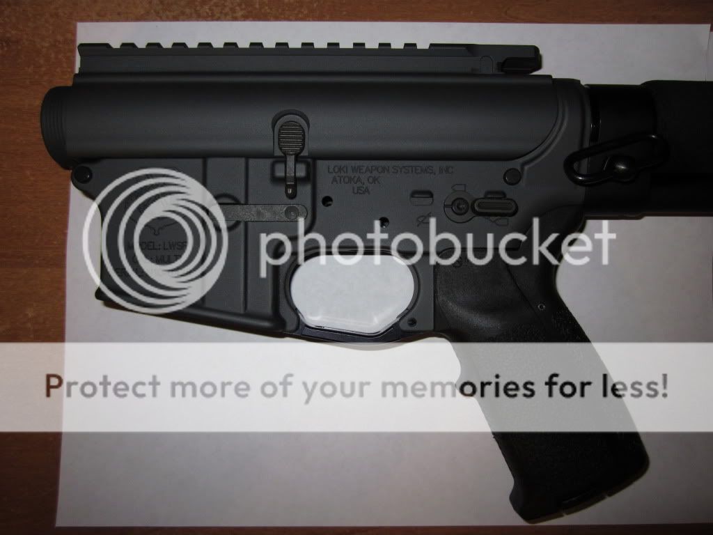

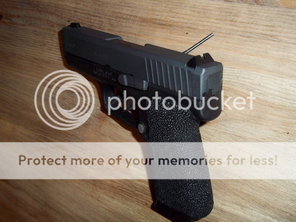

I finally had a few evenings at home during the week, so I decided to do a little spraying. The Kahr slide/barrel is another members, but the AR is my Beowulf build that is only waiting on a brake before I finally get it put together. The slide, small parts, and AR are done in Sniper Gray and the barrel was done in graphite black.
It's not hard if you have all the equipment. The prep work takes up most of the time. Now I need something to try the Blue Titanium on.

Howd the front sight make it through the cure? Look ok?
Let me know if you need another one; i think I have a few here.
The front sight was fine. He is going to get new sights, but wanted to leave it on until he did so. I wasn't sure how that sight was going to hold up though and was prepared to start over if it melted.
The front sight is fine. I think I'm gonna replace it with an XS big dot anyways.
