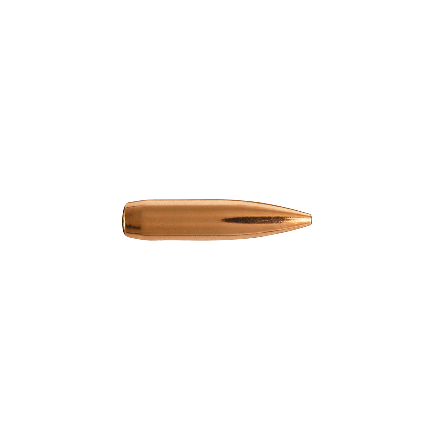

Picked up a few of these to try in AR-15's.
I tried to copy & paste the dope sheet for the 77gr OT .224 but just get the 175 .30 cal URL.
So just go to their ballistic Calculator & put in any Berger bullet then print out the Dope sheet.
I use the 175gr 30cal Berger in my .308s with Vitivouri 130 powder or IMR 4064 in a Bolt & AA 2520 in the Gas rifles.
Got to try this one it looks exciting for long range 5.56 rounds.

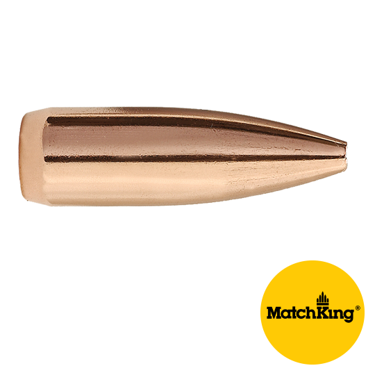

I did too. I hope we both see good things with these. I'm expecting alot from these. I'm gonna roll up on some known accuracy loads that my guns like using the 77gr SMKs, 24.8gr of 8208, 23.9gr of A2520 and 23.4gr of TAC
