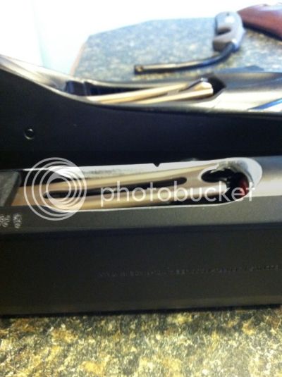

Any updates on how the Vinci is working? I have a Vinci for hunting, and was thinking of tinkering with it for 3gun. The one big problem is I'm having trouble trying the load 2 with it. After I put the first 2 in I will 9 times out of ten have the next shell I try to put in bind up or hit something. It is really pissing me off! I am a litte shy about getting the dremel out, but it might happen here shortly!

I was having the same problems with mine and the quad load. I could drop a deuce just fine, but quad was slow if not a yard sale. I took a bunch of material off the load port with a dremel and sand paper, and it loads as easy or easier than my M2 that is also opened up. I'll probably end up welding the slot in the lifter, as it breaks my thumbnail occasionally.

Care to post pics of the port? I'm fixing to get after mine.

Yes, pics please.
I have noticed that the mag tube is really deep set in the loading port. It looks like a lot of material could be removed to make the angle of the shell into the tube less extreme for a straight shot in. I'm a little hesitant to start dremeling away the material on a $1200 gun!

you need to remove plastic from the area of the front of the trigger guard, not necessarily from the front of the load port

Got any pics? I likes da pics!

Here's one that's kinda blurry. I cut the top of the port so it is more parallel to the bolt. I took about 5/16" or so off the front of the port to expose the follower and beveled the top of the shoulder that the mag tube butts up against so it won't catch the first shell and cause a yard sale.

if you look at the side view of the vinci receiver, youll see that the whole bottom (top surface of the load port, is not parallel with the bore of the mag tube. this means you need to take a steep angle when feeding shells. I would start about where rigpig's depth is, and then take that back as far as you can go, making sure you just remove solid extra polymer.

I could definitely take a little more off the front of the port and blend it a little better. This was my first attempt at a polymer port and was trying to stay somewhat conservative, as it's always easier to take more off than to put it back on! I left it like this to trial run in some matches and this profile works for me as it is. There wasn't much in the way of other people posting pics of their port jobs yet, so I basically combined what I saw Pat Kelley do with his and one other poster on Benos. It loads a lot better, now it's up to me to keep up with practicing my quads!
Here's somewhat of a side view. As you can see, there's still plenty of meat there to form about whatever profile your heart desires. (Vinci in background, M2 foreground)
