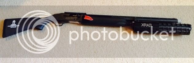

I'm getting ready to add an XRail to it as well. So it'll be super front heavy when loaded.
thats something that definitely could warrant aft balancing. Look into one of those Lead AR-15 stock weights they use for high power rifle shooting.see if you can carve that up to fit. that would be interesting

Here is the mostly finished product. Xrail came in today, my red dot should be in this weekend. I do like the added weight in the stock with the Xrail up front. Seems to swing better than the one I borrowed to try out that didn't have any weight added. She is heavy as hell loaded, but not super nose heavy so it's not bad. I'm gonna take her out this weekend and do a local 3gun match. That'll be a better test than just messing around with it at the house.
I call her Bertha
