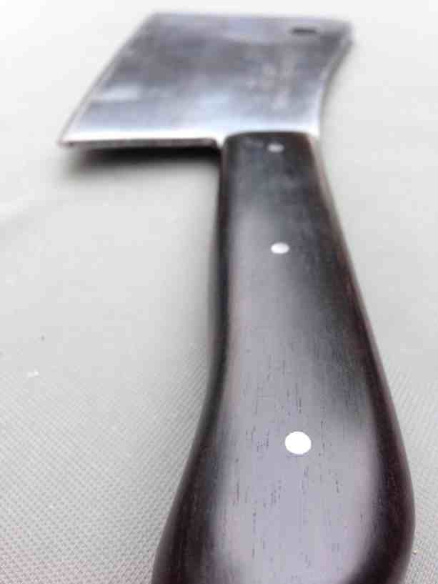

Here's the final product for the cleaver. Gabon Ebony, sanded up to 2000 grit and oiled.
Well, it's done. Far from the rusty heap it was.....
Still debating on whether or not to finish/polish the wood or leave it alone, but this Gabon Ebony is GORGEOUS in person......

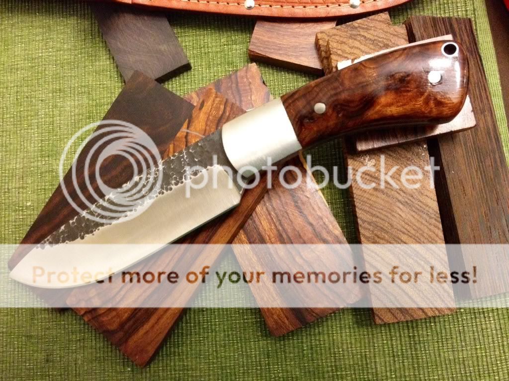

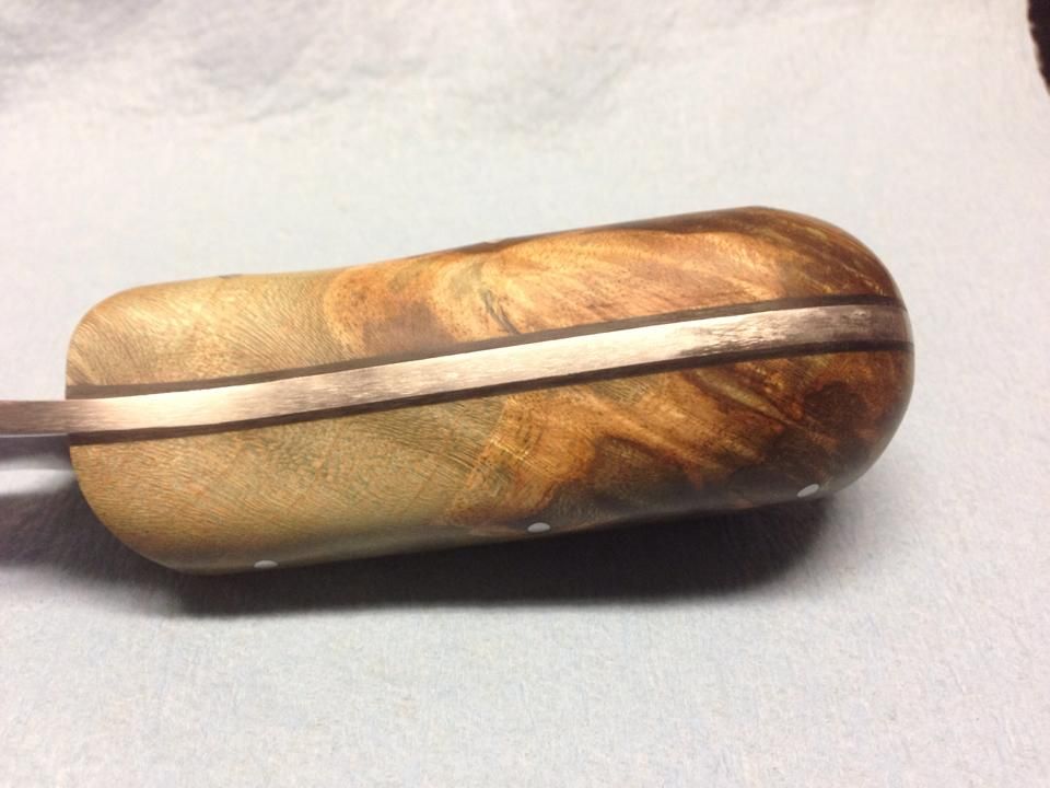

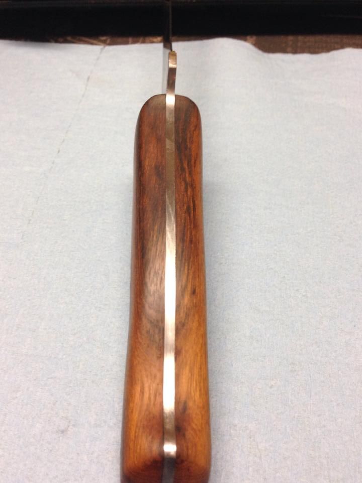

Well Papabear it's not as nice as some of yours but I finished my first knife. It's a 7" blade with burl ironwood scales finished with TruOil.
That looks really nice!
I've been trying to stay away from the knives with bolsters, as it's easier to finish without them, but that looks really nice!
Is the lanyard tube just epoxied in? What kind of pins are those?
The bolster wasn't really difficult to work around, I just put some blue tape on it to protect it. The pins are stainless because nickle silver rods in 3/16" were more expensive. The lanyard tube is 1/4" SS also and it's epoxied in as well as the pins. Do you peen your pins or just epoxy them in?

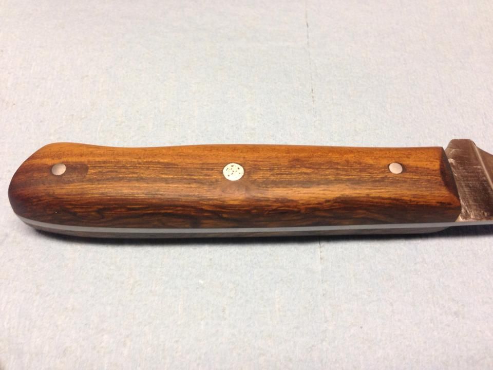

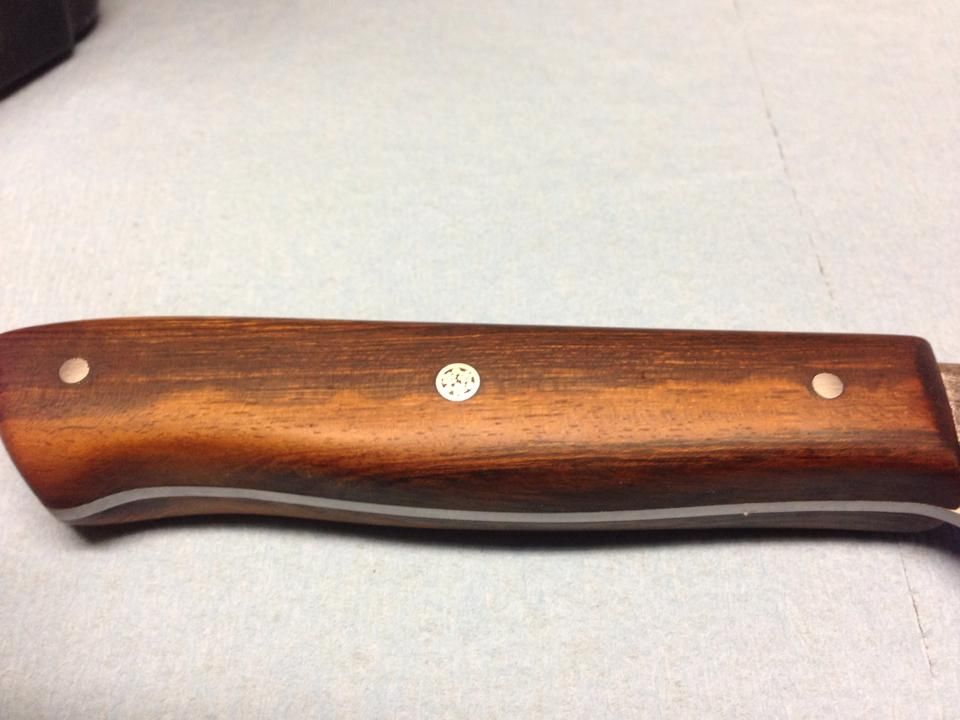

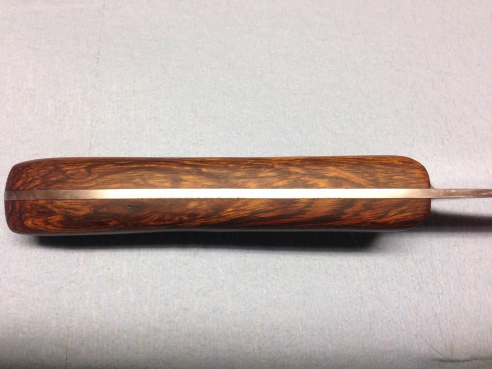

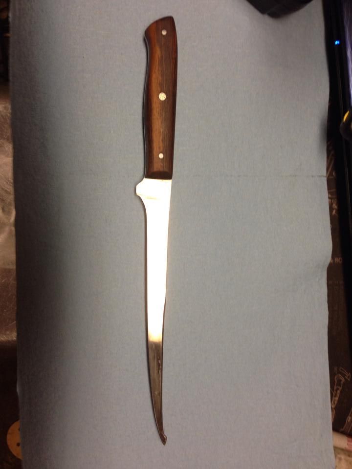

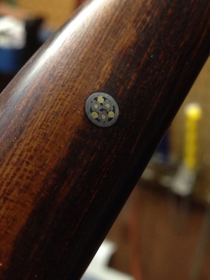

First is a filet knife that was bought by a friend of mine, to be a gift to his brother in law. It is a panfish/trout filet knife, sharp on the swage of the knife as well (top of spine at tip)..... Scales are Desert Ironwood, with a mosaic pin thrown in for looks. This wood is gorgeous.....
Next is an oyster knife done in Figured Maple, with mosaic pins. This was sold to another friend, as a gift for his best man in his wedding coming up very soon. I am also doing more basic knives for all of his groomsmen....

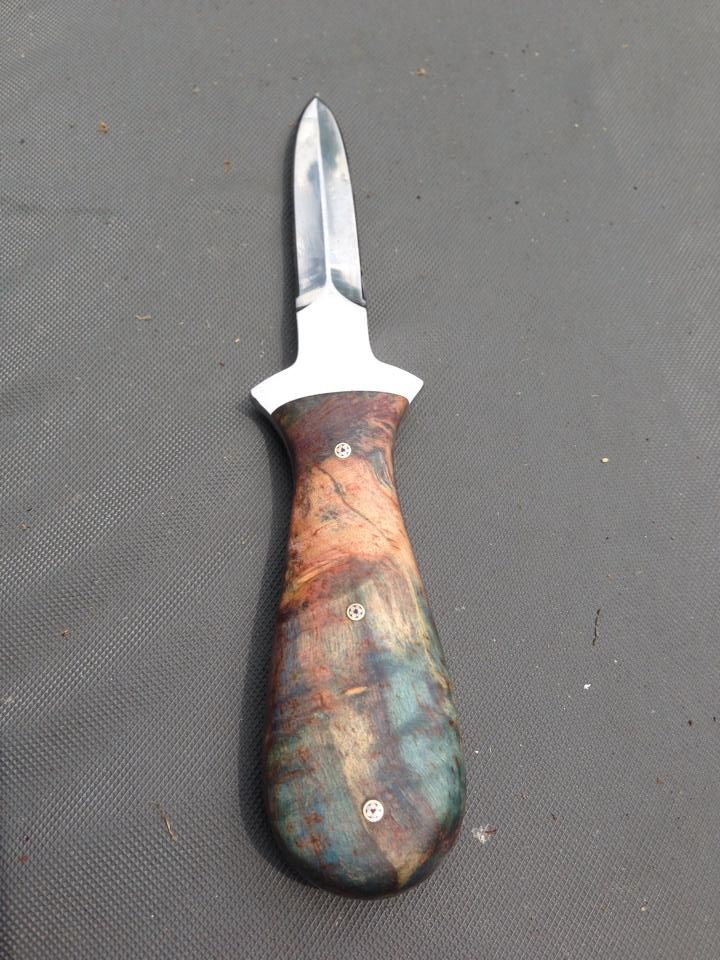

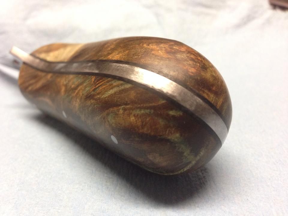

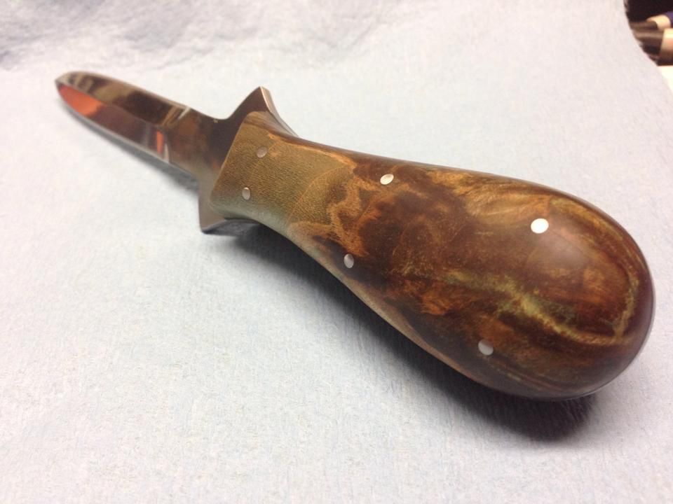

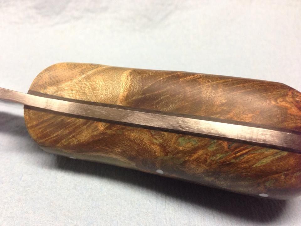

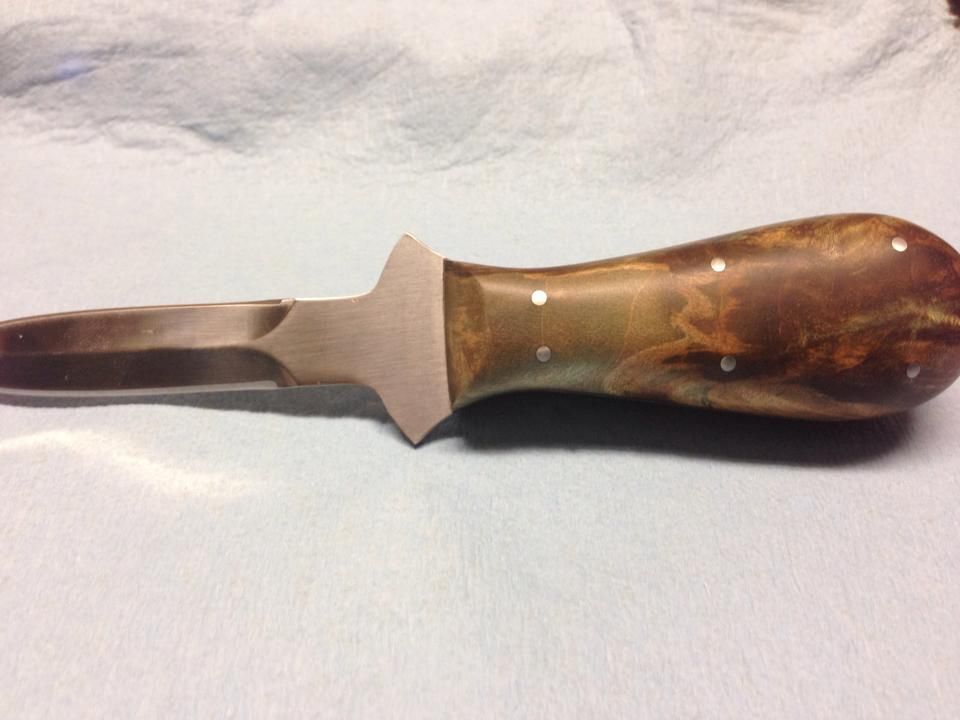

And my new favorite. This is an oyster knife done in Stabilized Spalted Maple Burl, with black G10 liners (piece between scales and blade), with 6 stainless pins. This wood is exquisite (read: expensive) and was done for a friend of mine as a gift for his wife for their anniversary. He wanted a "camo" look but done in wood.....this fit the bill quite well.

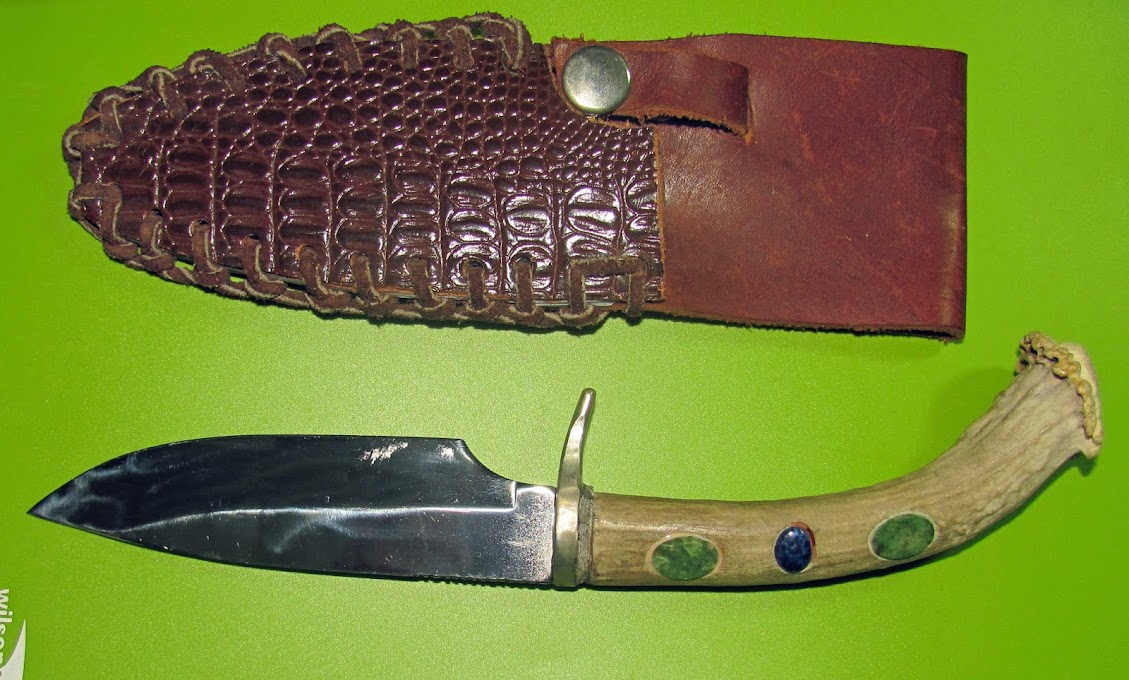

Neither pics nor knives as good as those preceding.

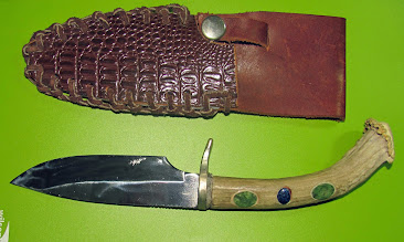

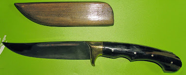

First is a table knife I made about 20 years ago for SCA events (your knife is really your only implement). Please excuse the cabochons, it was the early 90s.
Second one I didn't make, but is interesting nonetheless: Cretan shepherd's knife. Handle is sheep thigh bone and cloven like a hoof at the pommel.

Where did you find the filet knife and oyster knives. Those look fantastic great job 8-)
Did the figured maple have that much blue in it or is that the camera?
Oh it's blue. Looks awesome in person, but they're not all the same once you shape them and oil em. They are always even different than the pictures on eBay lol.
The blades I have been getting from premium knife supply mostly. Great shipping and have been some real solid blades.

Also, I took the figured maple and the spalted maple in the boat to the beach with me over the weekend. They stayed wet with salt water for and hour before I realized the bag they were in was soaked.
Dried em off and they appeared fine, but over the course of the day being wet and then dry and wet and dry all day with salt water, I could tell they were drying out a little. Not letting them go until they get some more oiling cycles. I don't want to use the tru oil like a coating. I just want it to absorb and protect.

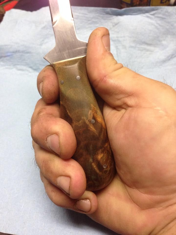

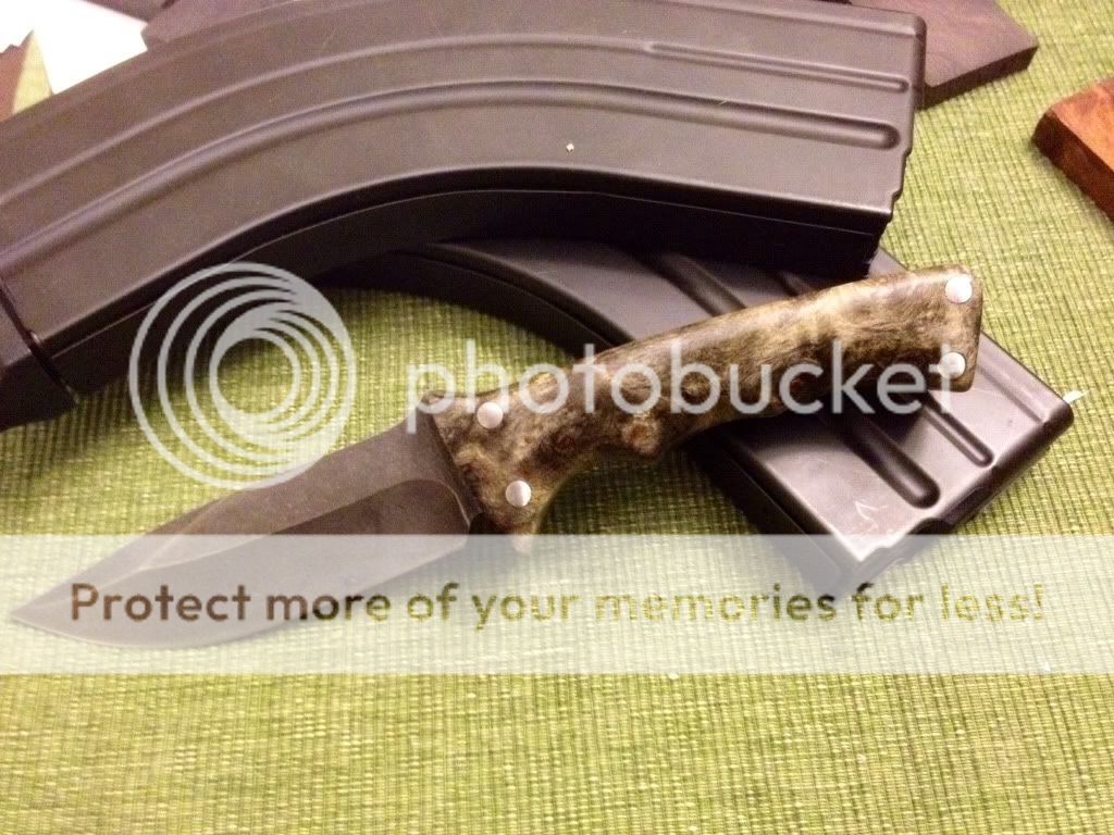

Here is my lasted one I finished. It's the lone survivor blade with stabilized Buckeye burl scales finished in TruOil. The finger grooves were tricky and time consuming.
Curious as to how you did them for that blade....did you shape them after pinning to the blade? Or shape them and then pin them?
I got the same blade, and shaped some G10 to fit and then pinned them on, but the finger grooves don't line up how I like.....
Yours looks awesome by the way.
I rough cut the shape to the scales then drilled the holes for the pins and dry fit with out epoxy for most of the shaping which mostly done by hand because I did want to take off the black wash finish of the blade. Once the the scale shape matched the metal I pinned and epoxied the scales which were still flat that point. Then I used my dremel to do the finger contours and finished sanded by hand. It was time consuming but worth it. Now I'm looking into doing a Kydex sheath for it. Good luck on yours are you using the screw type fasteners that came with or you going to pinn it like I did?
