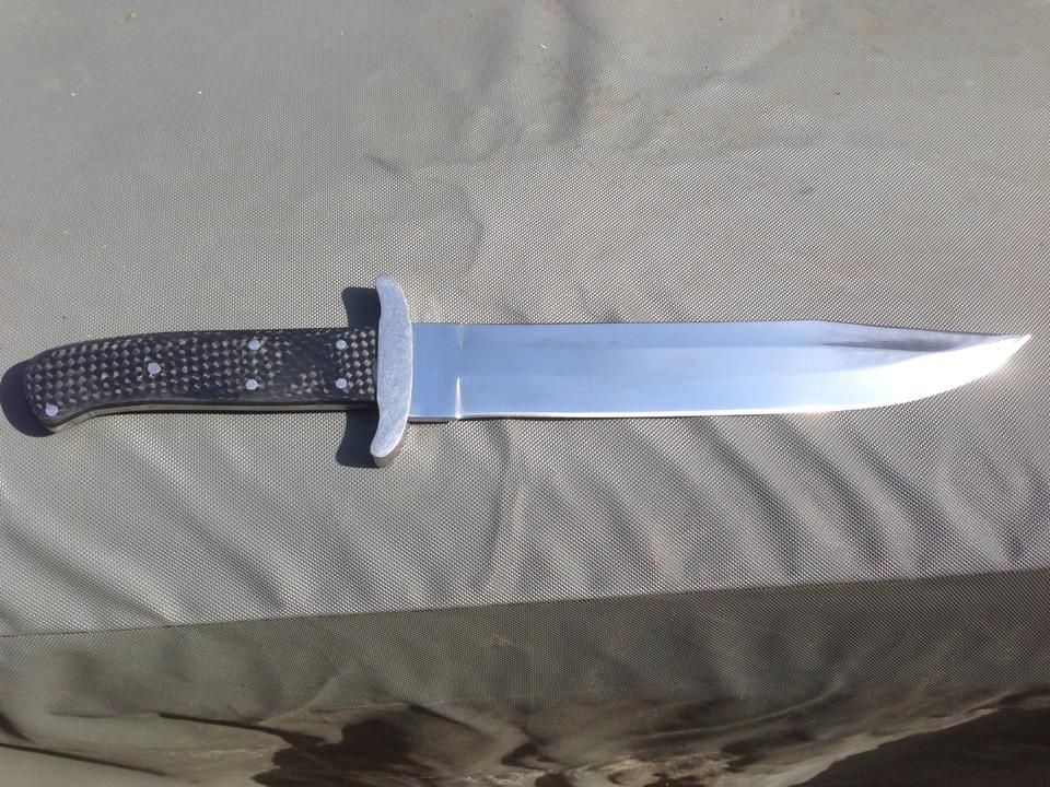

I found this old knife in my father in-laws stuff. It was really weird and beat up and the scales (handle) were broken. So I took the handles off, buffed the blade out and sharpened it. Not shown in this pic is that I also cut off the second bolster off of the handle. Seemed pointless and didn't feel good in my big hands. .

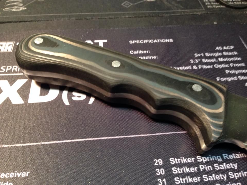

Then I decided to make some scales for it with some carbon fiber I bought on eBay that turned out to be pretty crappy. Proceeded and made some scales and pinned them on. Sanded to 600 dry, then 800 and 1200 wet.
Turned out pretty good I think....

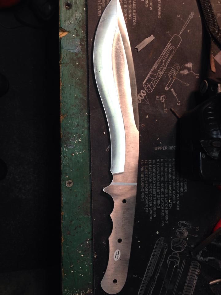

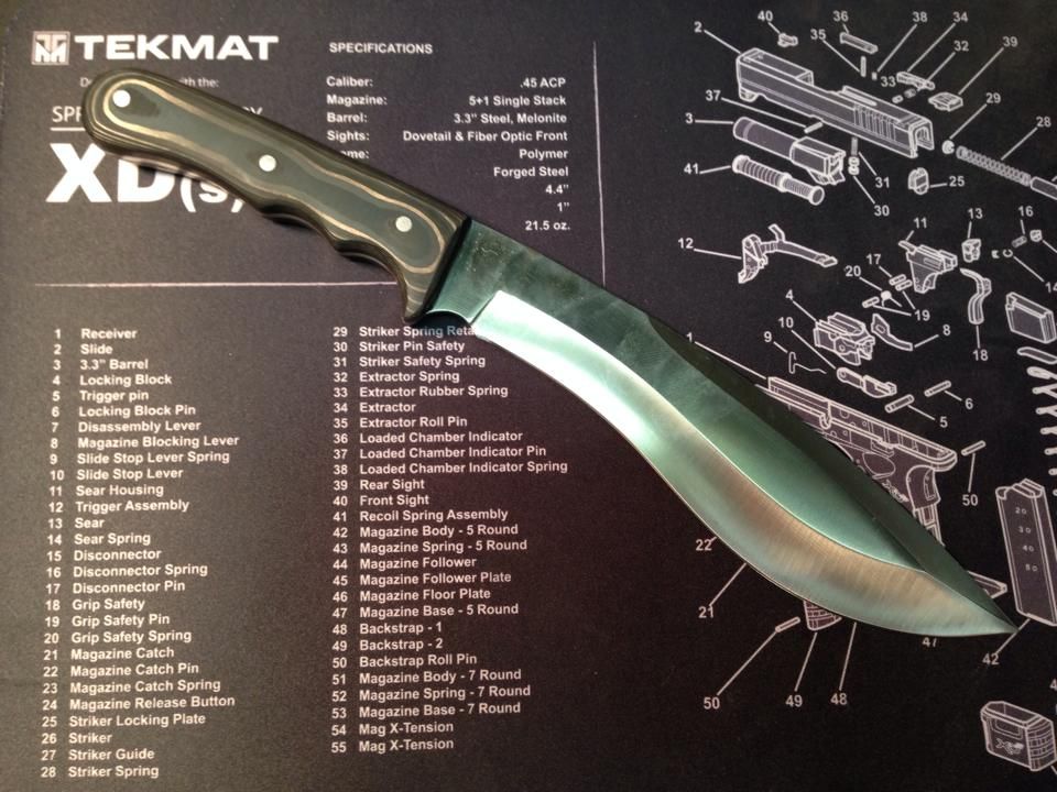

So I bought a Kukri style blade blank off of eBay, a decent 440C stainless. It's 14" long and weighs a LOT. I paid $13 for it, lol already sharpened! Same process as the other one, except I used some THICK carbon I found on eBay that was WAY BETTER. Sanded same deal, and got some AWESOME results. So, the rescue of the original knife turned into something I'm really enjoying, and it's not very expensive......thoughts?

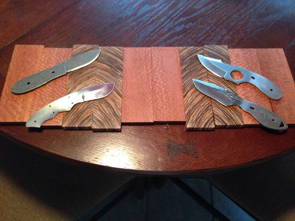

So, I've been on eBay, scoring some cool blade styles for $5 or so a piece for 440C stainless blades, already sharpened, including shipping. And some pretty cool wood slabs on there as well for about $8 a pair. This could be fun.....

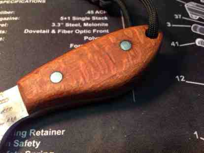

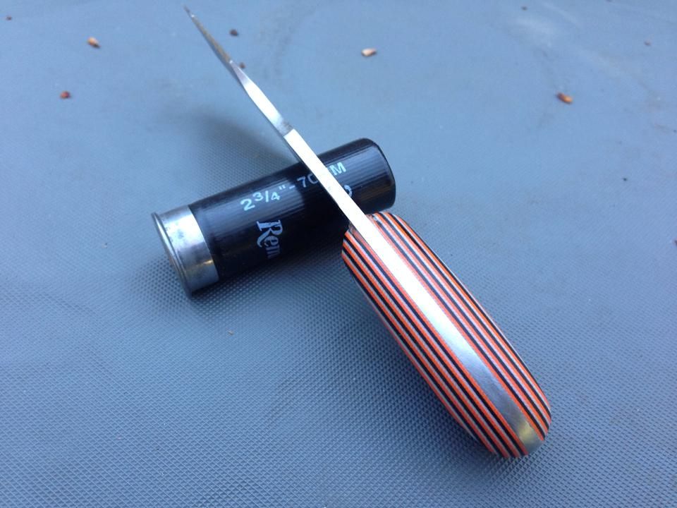

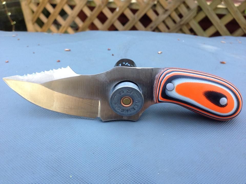

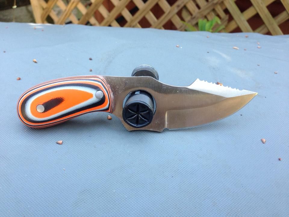

Hammer forged "otter skinner" with leopard wood scales and paracord lanyard.

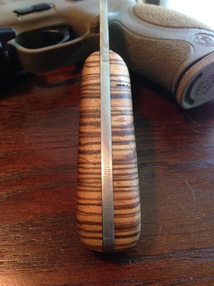

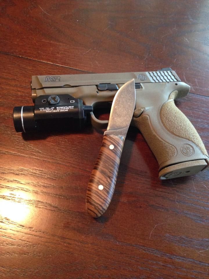

Zebra wood skinner with stone-washed blade. The scales were bookmatched pieces of wood, so the grain is consistent across the blade for the most part. This one was given to my brother in law. Perfect for skinning with his "pointer finger on spine of blade" style.....

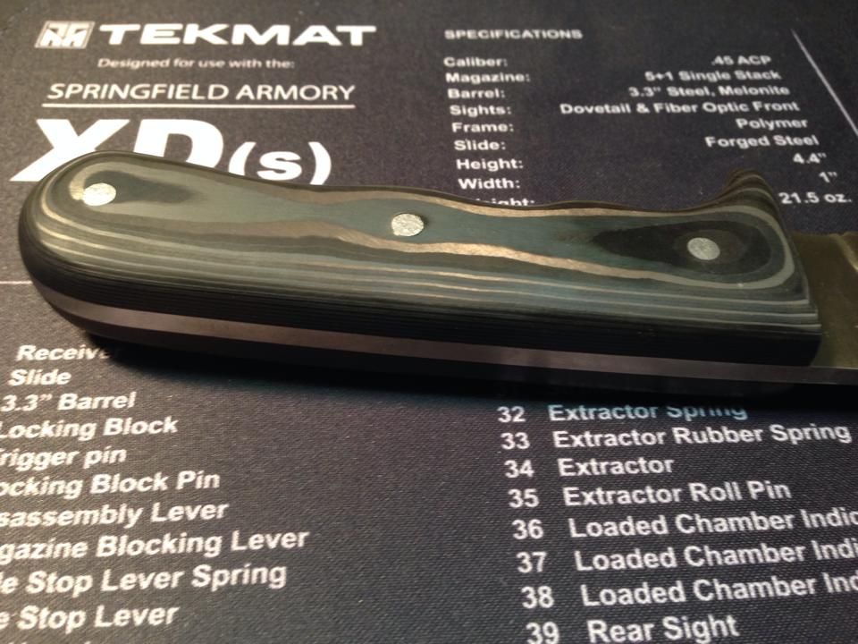

"Bengal tiger" G10 scales, on a 440C Stainless "Raptor" blade from premium knife supply. Feels pretty good in the hand. Really liking the G10 and the color options.....
Just finished these two as well. Kukri with Carbon fiber scales and mosaic pins (resemble a revolver cylinder). And another Raptor with Leopard wood.....

They all work about the same. 80/120/220/320/400 grits and done, all with relatively the same amount of "work" required to get the end result.
Wood is of course cleaner and less invasive to work, just because of the dust. Carbon fiber and G10 (G10 is a composite too) make some horrible, stinky, nasty dust. Even with a dustmask and shop-vac hooked to my belt sander, black boogers are present even after only 10 minutes of work. That, and the fibers will make you itch just like fiberglass insulation.
I resorted to a very large shop fan blowing out of my garage, with a dustmask, and a t-shirt covering my face for added protection. Also, to prevent the itching, I've been wearing gloves and some Tyvek sleeves on my arms. I work in a manufacturing environment where CF is present, and I have worked with the people responsible for monitoring safe concentration levels of it in the air, so I know what it will do to your lungs.
Think of asbestos. Same problems can be caused from CF fibers and fiberglass and the like. So if you're going to work with CF or G10, please use some protection.

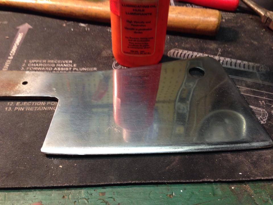

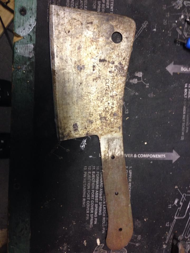

I got this old meat cleaver from a friend who was going to sell it at the flea market. I paid $20 for it and am super glad I did. I can't find much info online about the maker, but it's OLD for sure.
It's stamped "Royal Brand Cutlery CO, USA" and is 3/16" thick, and HEAVY. The tang was not finished, with burrs along the edges, and the center sections rough and not finished. I wanted to retain some of the "character" of the blade, so I didn't get too aggressive with the sanding, but I took all the rust away.

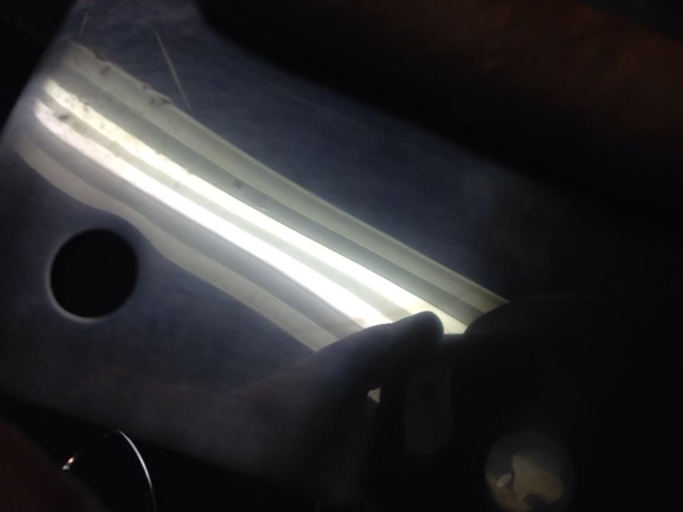

I started with 46 grit, worked to 80, then 100/150/220/400/500. These 2 pictures are at 500 grit. Notice the "pitting" in the second pic. This is the stuff I wanted to "preserve" in the final product for history's sake:

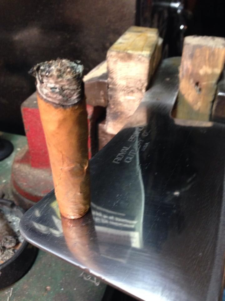

After 1200 grit:
And after 2000:
Tonight I will polish the blade and finish the edge on it. When I got it, you couldn't cut butter with the thing, so I put a preliminary edge on it last night, and will hone it tonight after polishing the blade.
