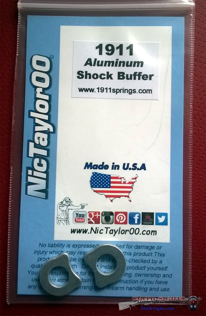

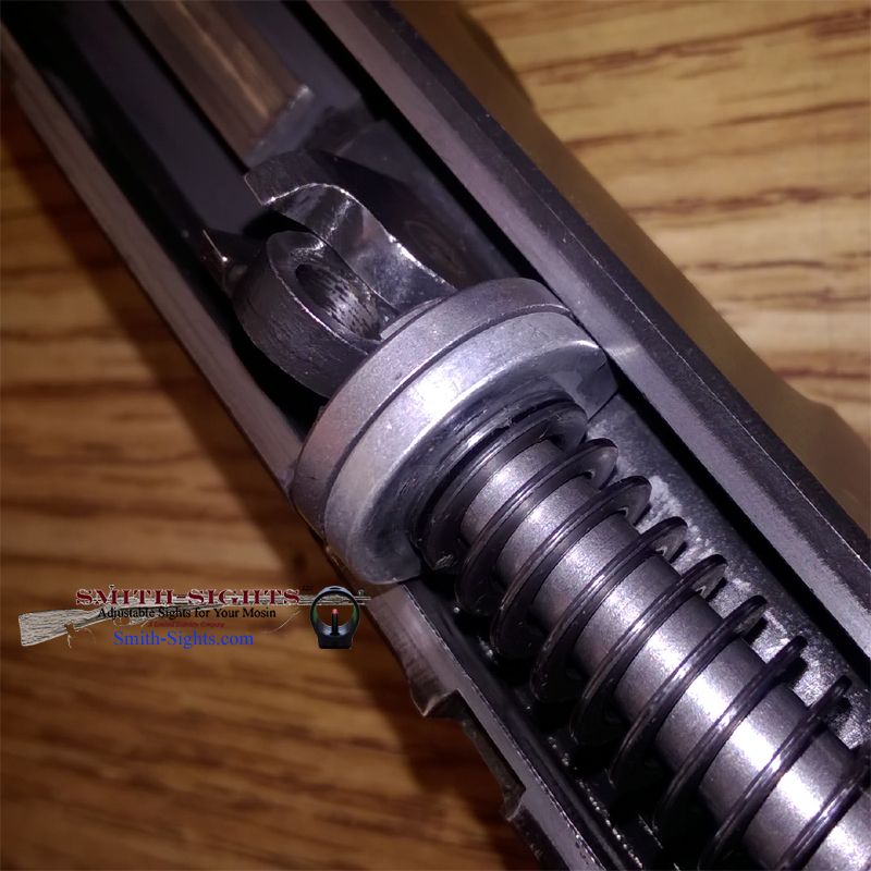

Hello,
I've wanted to try these for a few years now and kept forgetting to order them. Just wasn't a priority.
It looks good installed:
And it seems to work:
plTHYItbj
I like buffers in my 1911s for a couple reasons. First, it "feels good" to pad the recoil. Second, I like to lessen the stroke a bit so that the slide can lock back after the last round before it speeds up too much. I've had to reshape notches in 1911 slides and find it irritating.

The buffer is supposed to protect the frame from the slide slamming against it during recoil.. A really nonissue IMO

I use the aluminum buffers in a .40 s&w 1911, set up for single stack competition in USPSA. It does take some abuse as the picture above shows. It also seems to speed up the cycling, allowing a slightly faster reset to fire the next shot. There is one in my double stack, Limited class pistol.
