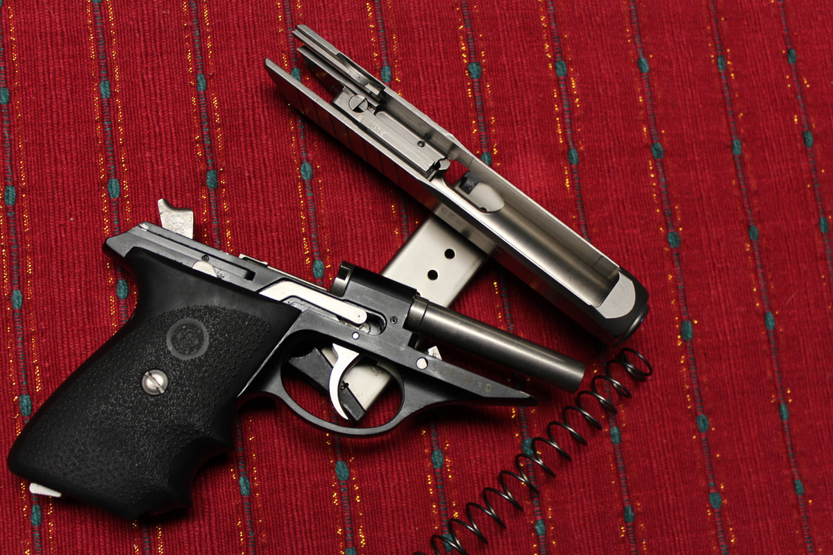

The 3rd pistol is a Sig Sauer 232..
https://postimg.cc/w7Fvxr8S
The SIG P232 is a double action (SA/DA), blowback operated, fixed barrel, autoloading pistol with a single stack 7 rnd.magazine,retained by a heel clip.
This P232 features an aluminum frame & has a wide, smooth-faced trigger. It's length: 6.6" Barrel length: 3.6"
From the operator's perspective, the P232 is one of the easiest to use autoloading pistols on the market. The only fly in the ointment is that the slide is difficult to pull back.
This is a common complaint with blowback pistols, as only the mass/inertia of the slide and the power of the recoil spring keep the breech closed when the gun is fired,
so the spring must be heavy. One suggestion is to rooster the hammer before attempting to pull back the slide.
That way you are not fighting the recoil spring and the hammer spring. (Both are substantial in the P232.)
some good info on the 232 is found here, https://chuckhawks.com/sig_p232.htm
EXCEPT the pistol he's reporting on is the all SS version (which I wanted to buy but couldn't find for sale, anywhere)
the all SS version has the heavier all SS frame, instead of the aluminum frame.
here's a pic of mine, apart: https://i.postimg.cc/9Mg7Yrkv/IMG-0613.jpg

JP, here's a picture of my P232 that my kids bought me years ago. I had the slide engraved a little and then polished,I really enjoy it.
My pistol looks identical to yours.. - the engraving & wood grips. Nice pistol, made to look nicer.
Did your pistol come with those grips ? Or did you make or buy them ?
I've found (other than rubber grips,) the only grips available for a 232 have to be ordered from Europe .
I ordered them online but I forget from whom. I could not tell from your pictures, is yours blued? Thanks
