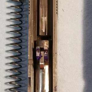

The firing pin hole is not round but oblong, and Kimber says that's by Design irregardless of how rough it looks. The barrel seems to be contacting the side of the slide causing damage. Kimber says that's within spec. You can see rough Machining marks on the ejection Port of the slide. Kimber customer service also states that is within spec. And you can see on the frame where it was roughly machined as well.
I was able to track down the email for the COO of Kimber. Send him these pictures and a short description. Within an hour he sent me another email apologizing for it and saying that customer service would be in touch. It took 3 days Brittany to call me after that. She said that they would send me a new slide and barrel. She refused to do anything about the frame. That was a week and a half ago and she sent me this very kurt email.
