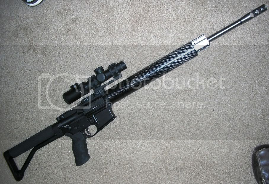

Several of the guys shoot factory JP rifles which are totally awesome. I personally didn't want to drop $3K on a CTR-02, so I built my own with a cheaper lower, upper, barrel, etc. Still has a JP gas block, JP competition trigger, JP low mass buffer, JP bolt group.
This gun is long but light! Jesse freaked out when he picked it up the first time...
