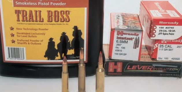

I have a .444 that likes it fast & 265gr heavy for cloverleafs at 100yds.
Yet I need a .44mag with .240gr bullets at let's say 1500fps not 2450fps.
Problem is I want my Marlin Rifle with a 24" BBL rather than trade for a Marlin .44mag.
I read about this powder, it's been described as little donuts that take up the large space in the .444 & the 45-70 cartridges.
Kaypok & Corn meal over a fast burning powder is danger ous, as hell. Gotta be a better way.
Anyone used this powder for safer reduced loads in large capacity cases? What ya think? Was it accurate at all?
I've been batting around the idea of trying it in 45-70. I haven't touched the press for about a year. I have used TB in .38,.357. It seems to do fine in that. Made my wife some light 125 grain .38's she really enjoyed shooting.
I met a guy shooting a 45-70 at the range last RSO duty & he swore by it for his 400 gr loads.
His 45-70 was a single shot that seemed to be much easier to handle with Trail Boss than his IMR 4198 loads.
Before I spend $38.00 a pound for this powder I need to know if it's worth it. My IMR-4198 cost $8.00 a pound
& it works just too good, but kicks like a MULE!

I use it in 45 LC , 44mag . 45 auto rim . It does look like tiny cheerios . Takes up a lot space in case . Impossible to accidentally double charge . Seems like a natural for 444 or 45-70 .

Trail Boss will work perfectly for what you are wanting and turn that 444 into the 44 you desire. There is a formula for loading Trail Boss which is attached. Basically just fill the case to the base of the seated bullet, no compression on the powder and this is your max load. This can be reduced by 30% to start. Will be fun to shoot all day long.

44 mag I use 17.6 grns. 2400 , 240 grn. Kieth style LSWC . 444 , 38 grns 2400 , 265 grn jacketed soft point .
Used to use the standard Kieth load of 22 grns 2400 44mag . 17.6 is fine for target shooting and much easier on hands . Trail Boss even easier , 6 grns Trail Boss 200 grn RNFP is fun .
My old Hornady loading manual has loads for 444 using 2400 . The show 30.8 at 1900 fps - 40.0 at 2400 fps . Bullets are 240 JHP - 265 JSP . I use no filler .
I got turned on to Trail Boss loading for my S&W 25 in 45 LC . Needed something to take up more space in the case . I've used it in 44 , 444 , 45 LC , even 45 Auto Rim .

Just did a little research . In a 44 with a 240 grn lswc , 6 grns of Trail Boss has similar velocity to 11 grns of 2400 . So , per ounce it's not that pricey . I use the same 6 ounce load for 44 - 200 grn rnfp , and 45 Colt -200 rnfp . both from Missouri Bullet .
