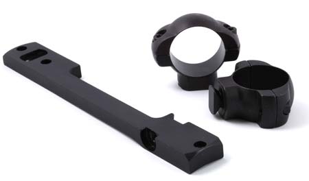

Base - what mounts to the rifle
Rings - what attaches the scope to the base - named for the "ring" that clamps around the body of the optic
Some examples of different kinds of Base / Ring combinations.
Standard or dovetail:
Weaver:
Picatinny:
As you can see, the Weaver and Picatinny systems are very similar. In a true Picatinny rail, the grooves are the same size and spacing. The Weaver is not the same spacing. The grooves are also slightly smaller for the Weaver base, which means - as KurtM said - that you can mount Weaver rings to a Picatinny base, but the other way around could require modification to the base.
There are also scope mounts, where the two above parts are one piece:
