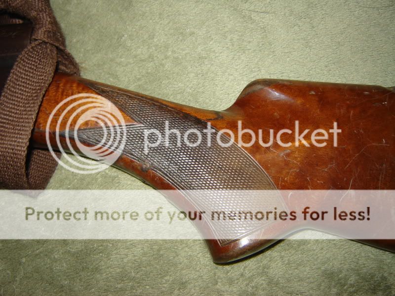

Halfcocked
Aug 1, 2010
100
Sounds like you have it in good hands,but here are some of the techniques I use just in case. As Henry mentioned the first thing I do is drill a hole at the end of the crack to keep it from running any further. I generally only drill a hole a little wider than the crack though, it easier to conceal. Then as Bill mentioned I force some AcraGlass into the crack and support it with brass stock screws if possible. I use painters tape a long the edge of the crack to help with any AcraGlass squeeze out and remove it before it dries completely. You can use surgical tubing if you have it but an old tire tube works just as well. This is an A5 Stock I repaired a couple of months ago using the same method.
