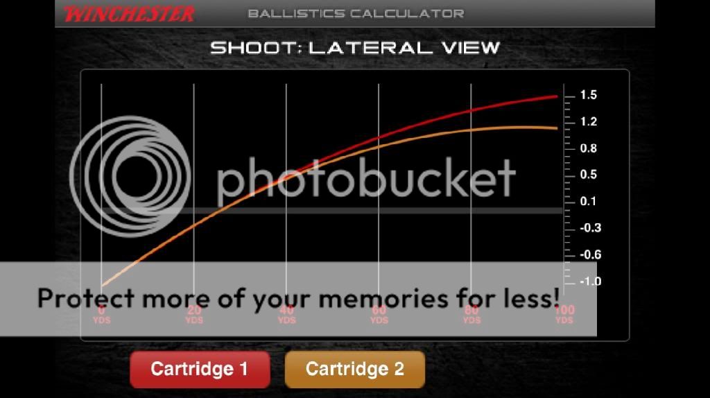

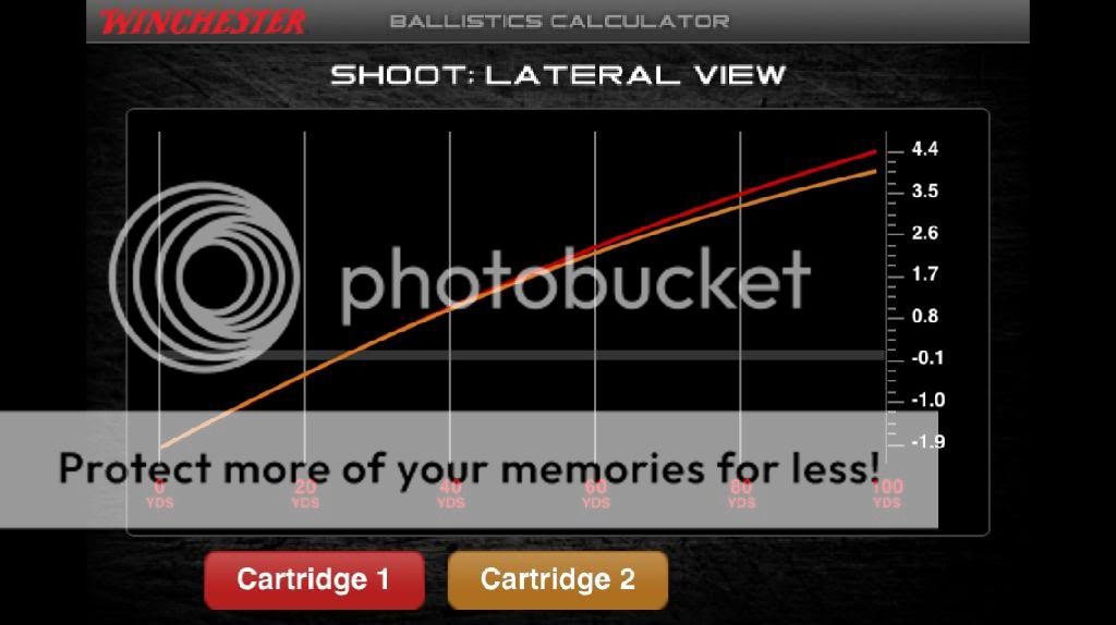

For #1 5.56/55/fmj and #2 .308WIN/147/fmj you see an apparent rise at 100 yd with a 2" scope height sighted at 25 yd.
But the apparent rise is much less with a 1" scope height.

Downloaded that ballistics chart after seeing this thread. Good info here. Any one got a good formula to determine exact scope height? Center bore to center of the scope? Buis center bore to top of the post?
Most of the BDCs I've seen have a notation some where on the page denoting 2" to 2.50" from center of bore to center of scope......I have no idea how you figure that in...I have always tried to mount my scopes close to the bore as possible figuring the less angle the better.

Using the first chart big futz posted, for that postulated rifle/ammo/zero combination, there is about a 4 MOA difference between the 25 yard zero and the 100 yard zero. If the shooter zeroed at 25, then dialed in 4 MOA of elevation into their scope/sights (16 clicks on a 1/4 MOA scope), they should theoretically then be dead on at 100.
Of course, I say "theoretically..." I think it is very hard to beat going out and collecting data with your gear. For example, a lot of scopes (especially less expensive ones) which advertise 1/4 MOA clicks are really 1/3 MOA clicks. YMMV with different ammo. Your scope may not be 2" above the bore. Etc.
