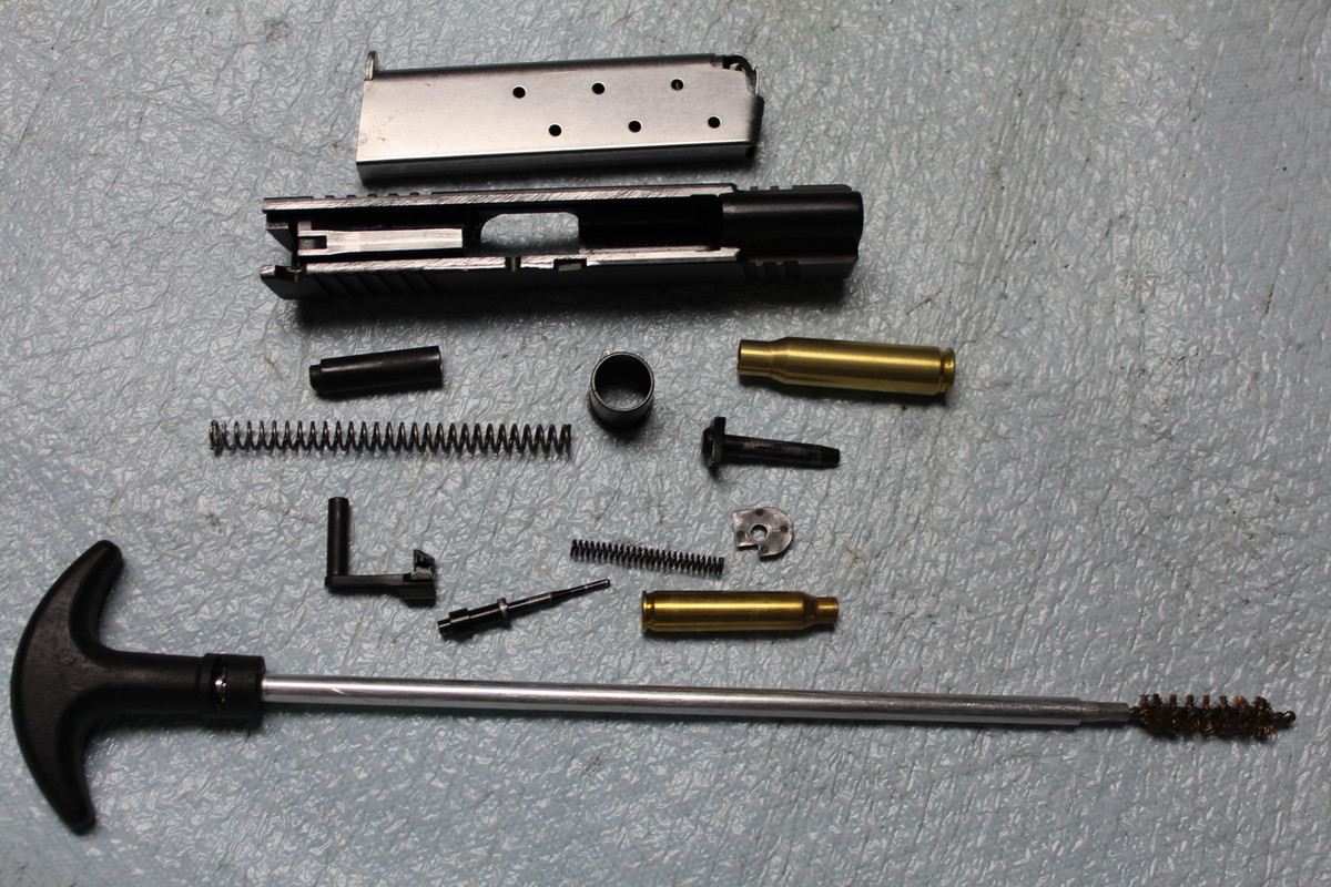

I was curious, so actually removed the slide to check out the frame, slide, barrel, & disassembly procedure.
Breaks down just like full sized 1911's, it has a short "G.I." style guide rod for the recoil spring, a short/small dia. recoil spring (surprisingly strong)
and the familiar spring plug, that is held in place with a typical 1911 barrel bushing. Bushing fits easily in slide & around barrel ( not tightly fitted)
Internal parts seem tiny, comparing them to a normal 1911.
I noticed several differences:
1 ) slide uses an external extractor.. as does some other brands of 1911's (like my Sig Sauer).
2) No barrel link / swivel beneath the barrel, just a metal protrusion on the bottom of the barrel that passes snugly thu a channel in the frame.
3) No locking lugs on top of the barrel, this 1911 is a blowback design.
Those are the only visibly noted differences.

& shoot it some more I will attach a few pics of it broken bown, I used a 308 & 223 case for size comparison
