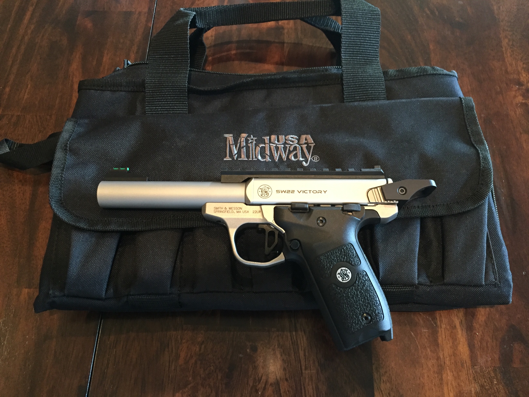

So, I'm going to start shooting RFPO division in steel challenge and I'm wondering what I should do next to my gun.
Current Setup:
Smith and Wesson SW22 Victory
Tandemkross Victory Trigger
Tandemkross Halo Charging Handle
In the Mail:
Cmore Railway Optic
Possible Upgrades
1. Volquartsen CF Barrel - I'm leaning towards this as the next upgrade. The factory barrel is HEAVY!! Since this will be a dedicated Steel Challenge gun I feel like it is front heavy is very unbalanced and will slow my transitions down.
2. Volquarsten Custom Grips - I've got Sasquatch hands and while I don't hate the stock grips, the Volquartsen grip look like they would be Perfect for me. I use the oversized Ergo on my PCC AR9 so I think these grips would be amazing.
3. Tandemkross Cmore Mount - this lowers the Cmore a bit closer to the gun over using the rail mount. I don't want to do a side mount. Does is really make THAT big of a difference that I would need the lower mount and see a noticeable difference?
4. Tandemkross vs. Volquartsen compensator - I'd like to go the Volquartsen comp if I get the matching barrel. Does anyone have an opinion about which one is better? Preferences?
5. Volquartsen Extractor - pretty cheap upgrade if I have issues with the gun ejecting.
Let me know your thoughts and opinions!
Also, does anyone have a Victory and does yours have a preference on a particular type/kind of Ammo?
