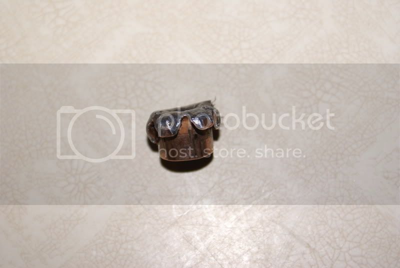

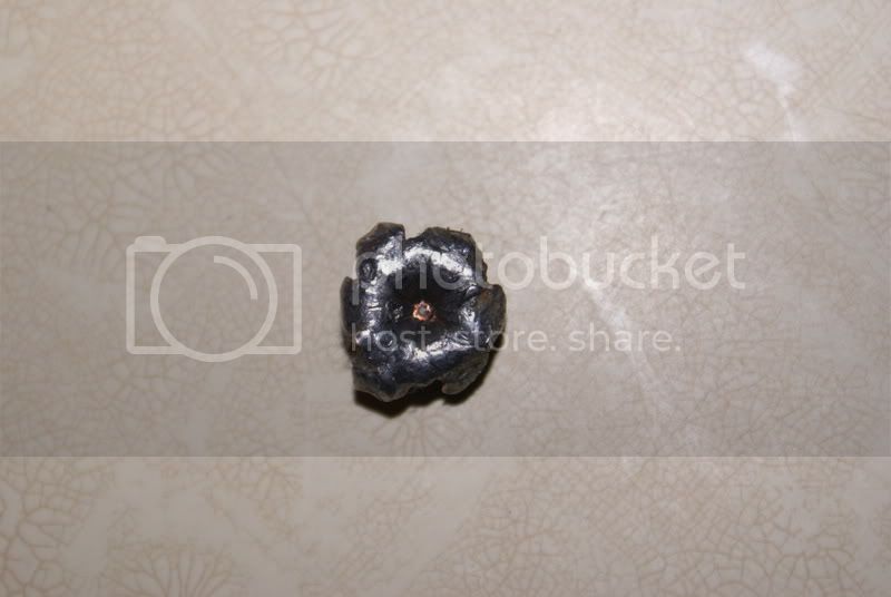

Here is some good info....you don't need a race gun or a specially modified 1911 to take game.
Of the rack with adjustable sights will do any thing you want.
Keeping in mind you will be shooting at close range, the .45 ACP is legal in Ok to take deer and I've taken two with it. One was a fall-over-and-flop shot, and the other was a 50 yd run before expiring.
I use 185 grain HP's loaded to 1100fps for hunting.
Here are some pics of bullets recovered from a deer and a bobcat.
The results:
