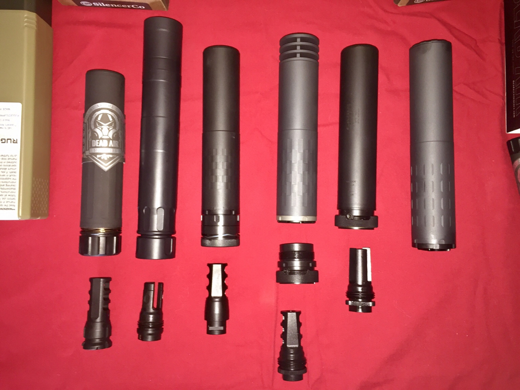

Good information. At first I worried a lot about how many different ways I could use the suppressor I was going to buy...but 1 can leads to another and now I find my current favorites are the dedicated direct thread setup. I know this goes against all the different QD mounts that are so popular right now along with the do-all, multi-configurable cans.
My SpecwarK is hearing tolerable on both a 12.5" and 16" gun. 223 ARs will never really be quiet. The entire baffle stack is stellite and the ASR mount works well. Best part was I got mine for something like $550 each. They are all I need for 223 ARs.
The Omega works on everything else.
A solid QD mount is advantageous in that your suppressor won't back off during use.
I'd also advise you to look at some of the shorter suppressors out there since many meter fairly close to fullsize cans at the shooter's ear. There's no substitute for volume with regard to overall suppression but backpressure and port noise can be considerably reduced when using a mini suppressor and that makes it more user friendly. Adjusting your gas can mitigate some of that too though.
Dead Air's new Key Mount seems very promising.
